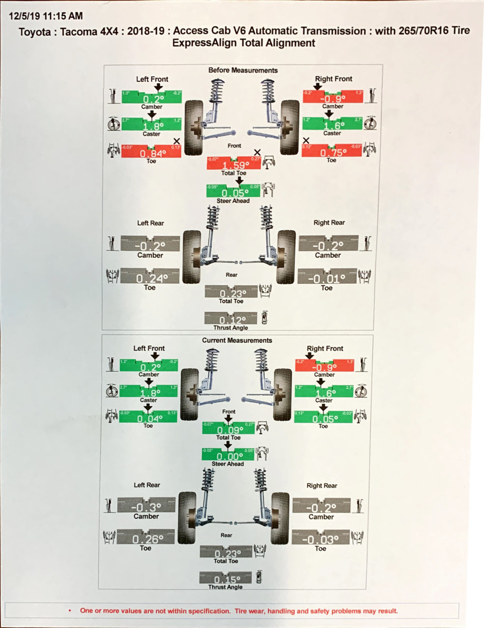

    So Firestone actually listened to me and didn’t touch caster. They also didn’t fix camber, but whatever.

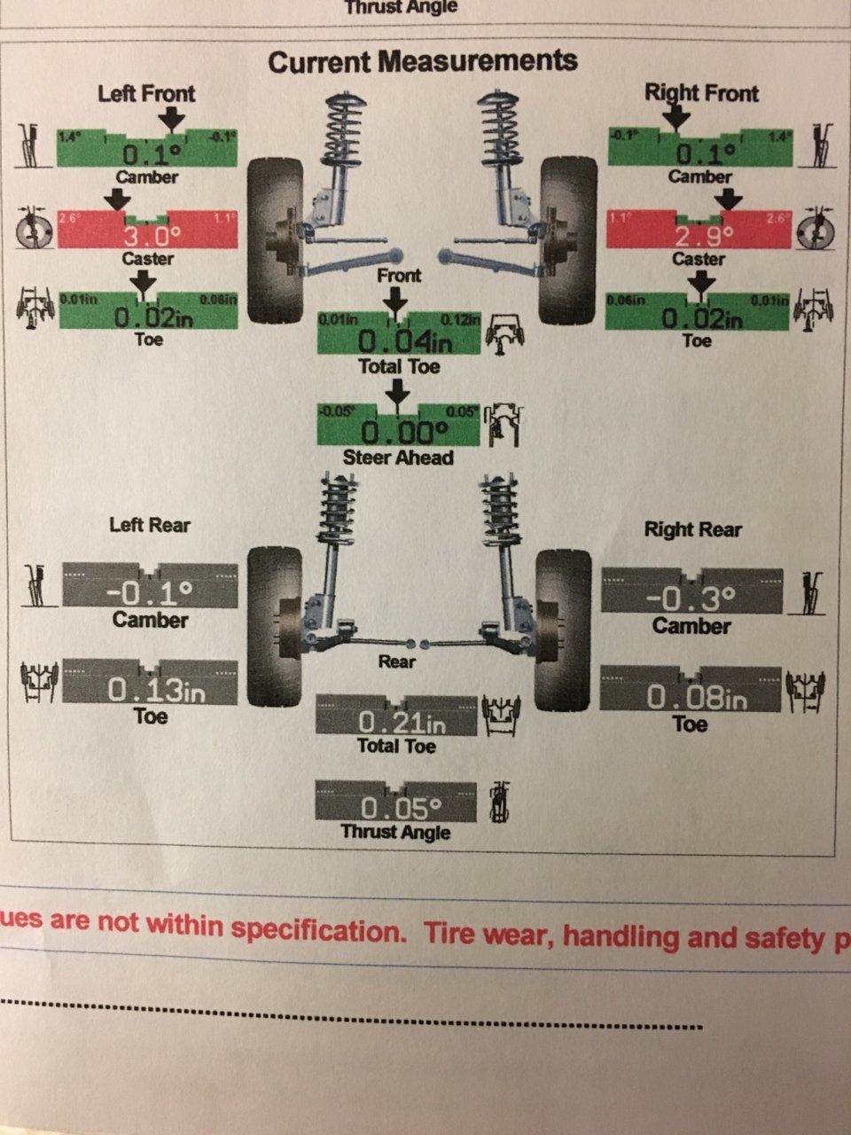

    66A2C5C1-2A0C-484A-875E-2AEFC5F0681E.jpg Some how my toe got way off so had new alignment done today. UCA set at “D”.. Drives great again.

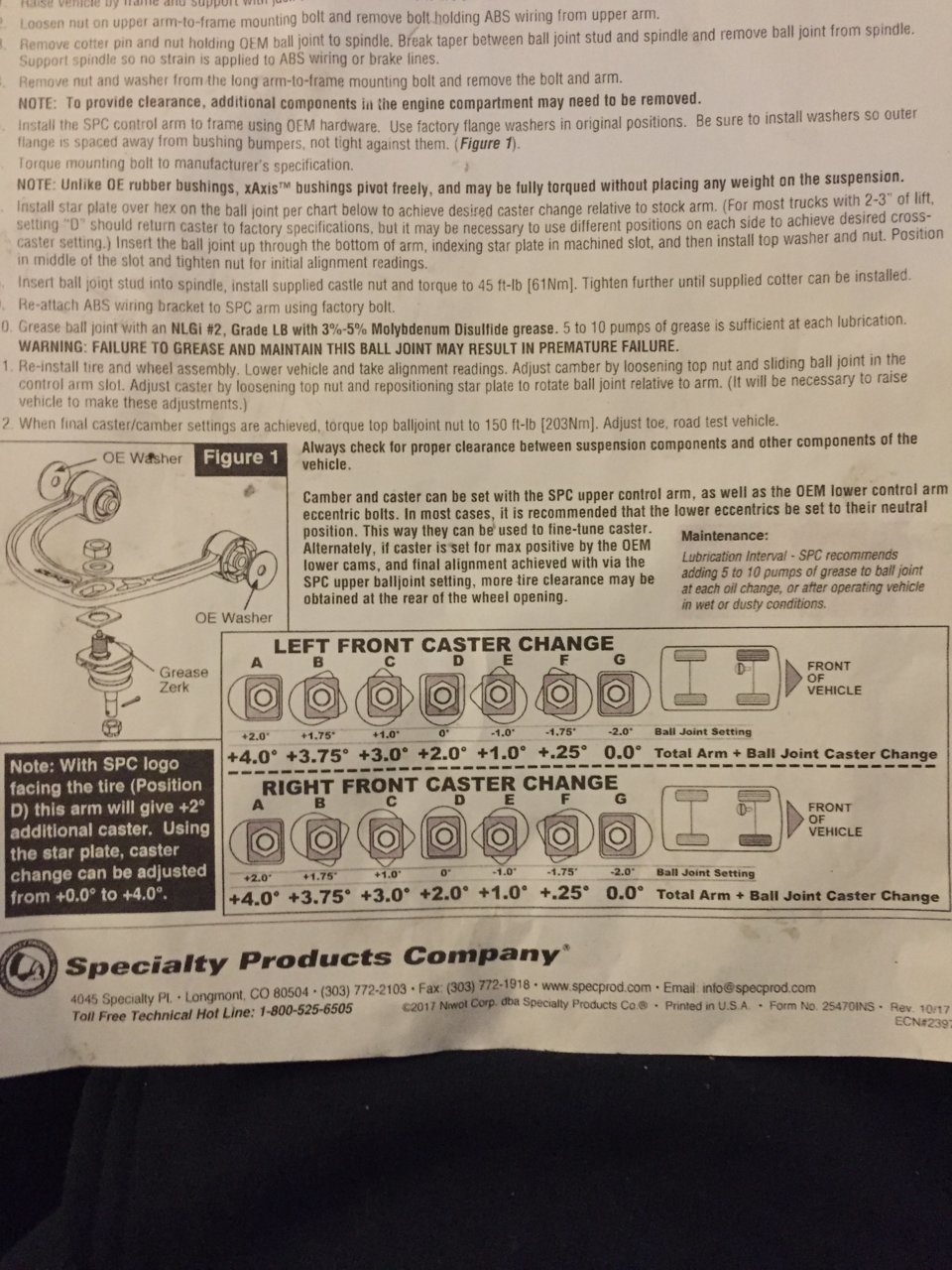

    That sounds odd. Position E is less caster than position D so something doesn't sound right. Maybe yours were at C and got moved to D. My truck was at C when I got it and it was twitchy on the highway and would dart back and forth. D made it better but my tires still rubbed more than I liked so I tried E and it feels better and rubs less.

    Position E moves the tire forward, further away from the CMC, position C puts it closer to the CMC. It's really a trial and error thing and once I started moving things around, I figured an alignment from a shop would have no guarantees with a lifted truck. I might get the toe checked if it looks like I'm getting some tire wear.

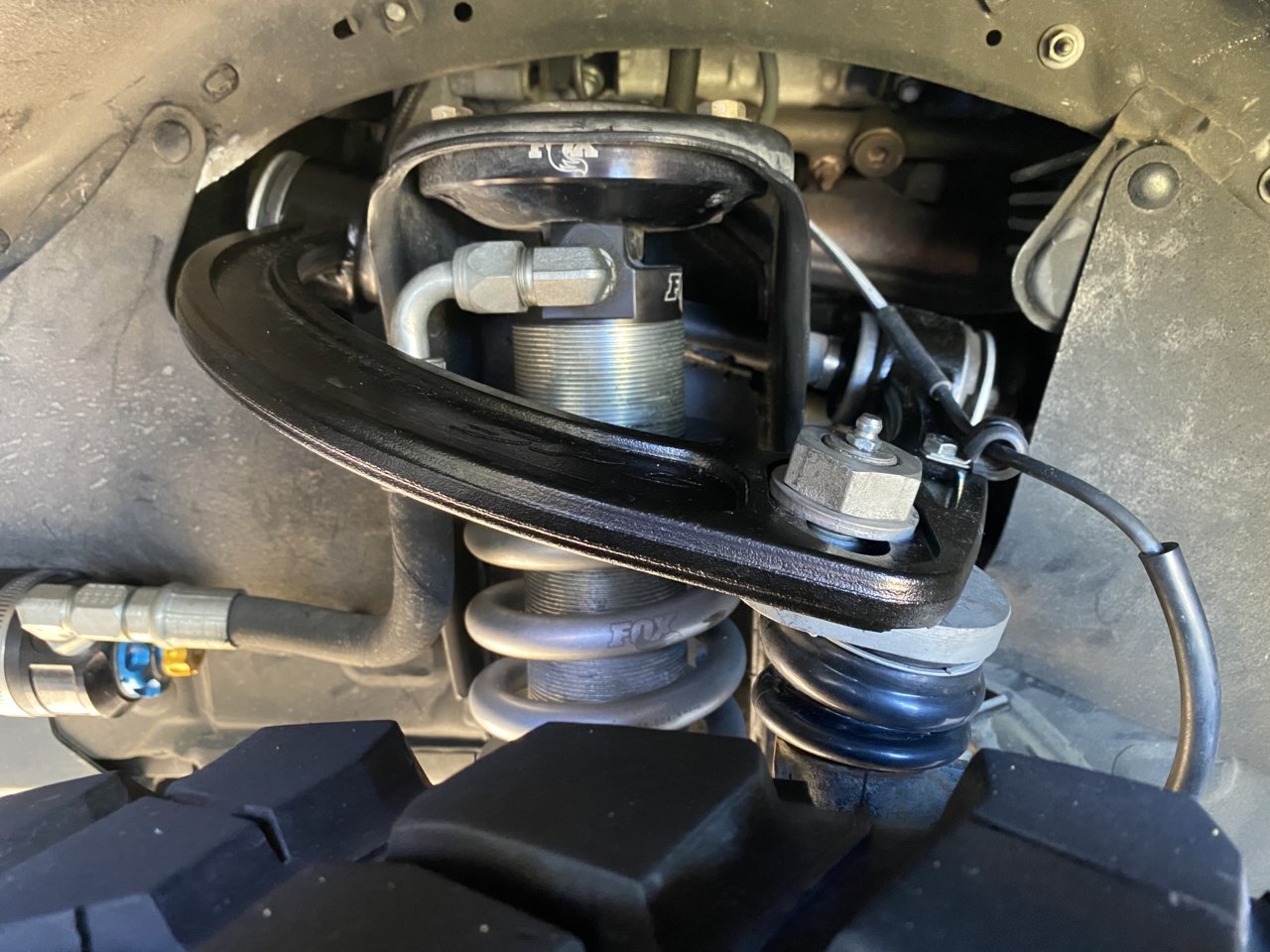

    I’m confused.. I installed my Spc uca and I’m trying to prevent rubbing on the inner fender. With 285/75r/16.. they are measuring little bigger than 32”.
    what position is this? A? And with max castor on the the LCA what position should I start at.

    Yeah, that looks like A which pushes the tire back. You want to start around D to see how it feels and how the clearance is. 285/75/16 tires usually are around 32.8", it depends on the manufacturer.

    Looks like G to me. Either way get your lowers adjusted to max out the positive caster first then dial it in with the cam position. The big knob to turn in terms of wheel clearance is maxing out positive caster with your LCA cams.

    The picture is the driver's side and the round portion is pointing to the rear of the wheel opening which would be A.
    You can't really measure the tire easily on the truck so it's probably closer to 32.8 than you realize.

    i moved to position A and it helped the camber for sure.. didn’t see much castor change. Going to alignment shop Thursday

    Right you are. Their images always confuse me. I still stand by my alignment recommendations though :D
