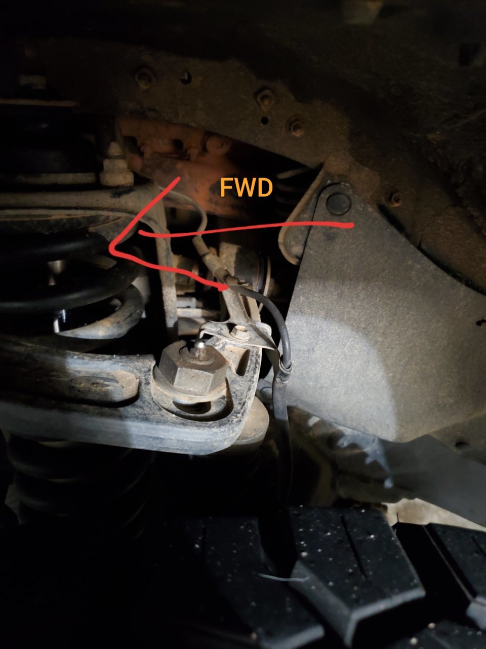

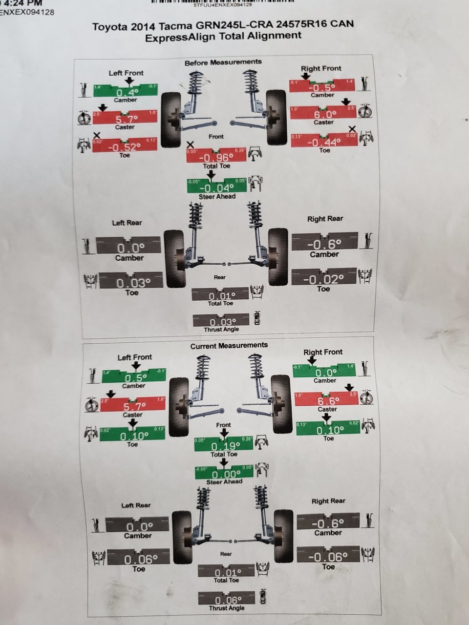

    Not to try and confuse anyone but here are my settings. I'm currently on 285/75 R17 (33.9") and almost have all my rubbing gone at full stuff. I also have a a Cab mount relocation, bashed over the cab seam and trim trim trim. I walked into Firestone and asked who has dealt with adjustable UCAs, luckily there was a tech there that understood what I wanted. I told him to max out the caster and that he did! Unless he just fudged the numbers to get me out of there. The truck handles fine on the freeway, steering was a little heavier around town. No complaints. IDK maybe I'm just driving a death machine with this much caster. 20191228_155644.jpg 20191228_155513.jpg

    Wow, that's a ton of caster. Looks like the arms are in position A which would give you a lot of extra caster.

    i ran my SPC's up to 6.1 & 5.9 once just to try it since it worked with fitment. but it didn't drive so great. the caster was there but steering feel and weight shifting was inconsistent across the front. i am a caster whore, but that was too much for my truck at the time, so we reduced it to its comfort zone, which was 5.2 at the time. since then I've installed Marlin frame braces that have further reduced its natural position to 4.1 on both sides. how is your steering on the highway, when you're actually steering?

    Initially, when I had the Mickey MTZ P3s on, there were no issues. It seems to wander a little at speed now after putting on the ridge grapplers. I'm assuming it's because my new tires are E load? I may back the caster off a smidge on my next alignment after I install my new coilovers, not sure yet.
