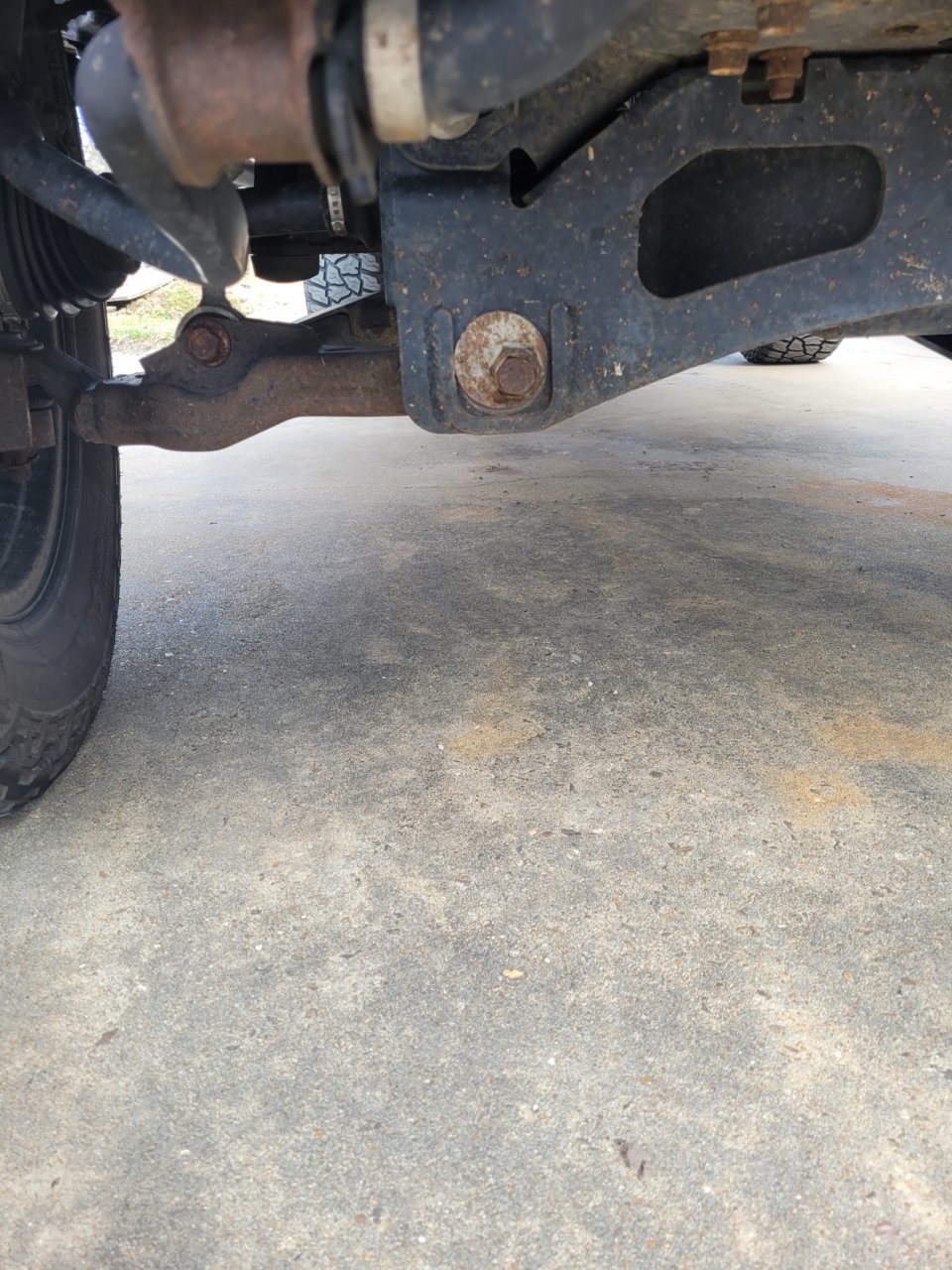

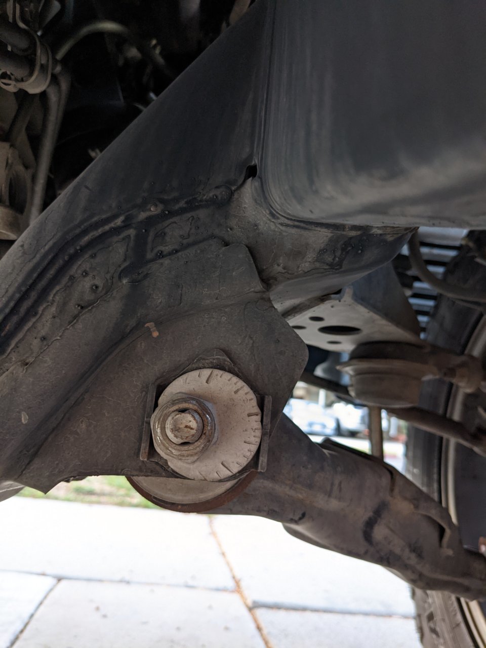

    Post photos of front and rear cams on your lca and also the position of the spc cam.
  5. Jul 21, 2021 at 7:46 PM
    #1265
    dirtnsmores
    dirtnsmores A camping truck
    Sep 24, 2015
    #165069
    3,307
    Southern California
    06 DCLB Prerunner
    OME885/5100, DAKAR MED-DUTY, SOFTOPPER

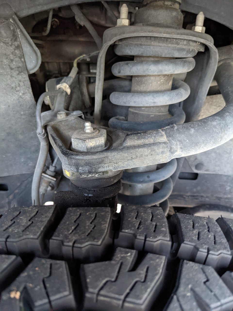

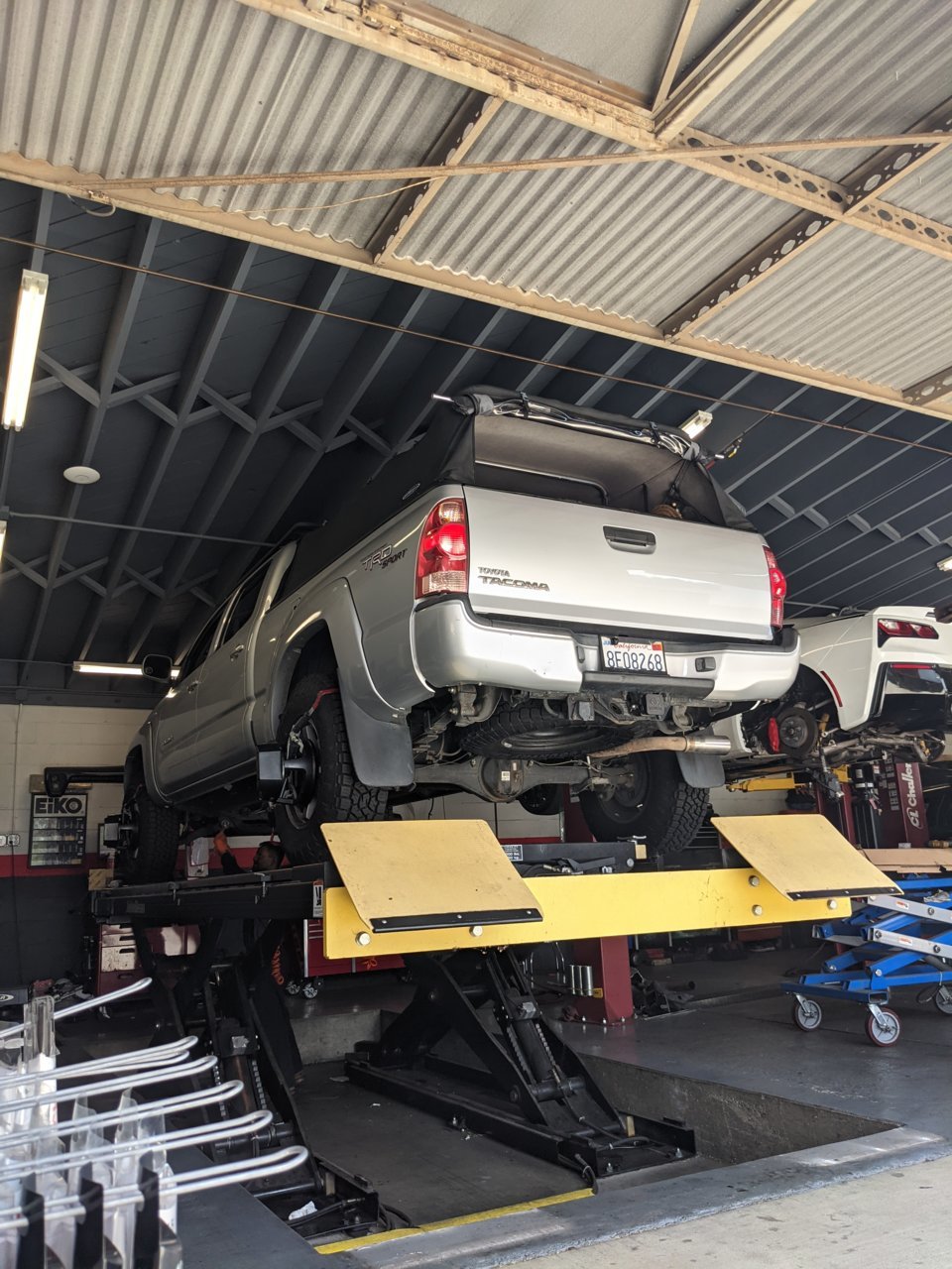

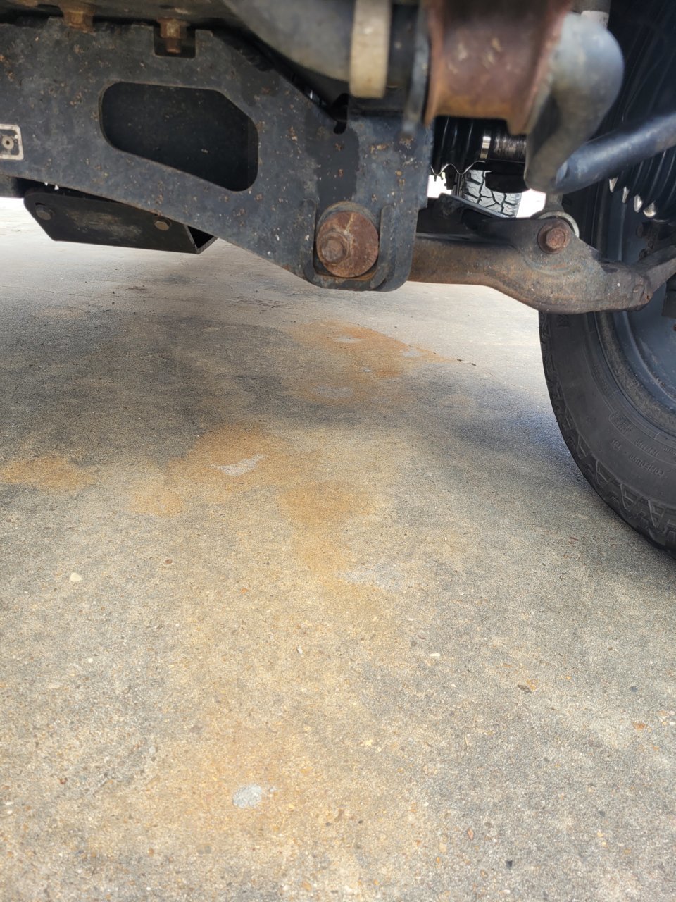

    Front
    Rear
    That should be the D setting. It's the passenger side
    @Asianguywithatruk I'm going back today to see if they could adjust it Forward more. Here are the pictures
  6. Jul 23, 2021 at 2:34 PM
    #1266
    dirtnsmores
    Sep 24, 2015
    #165069
    3,307
    Southern California
    06 DCLB Prerunner

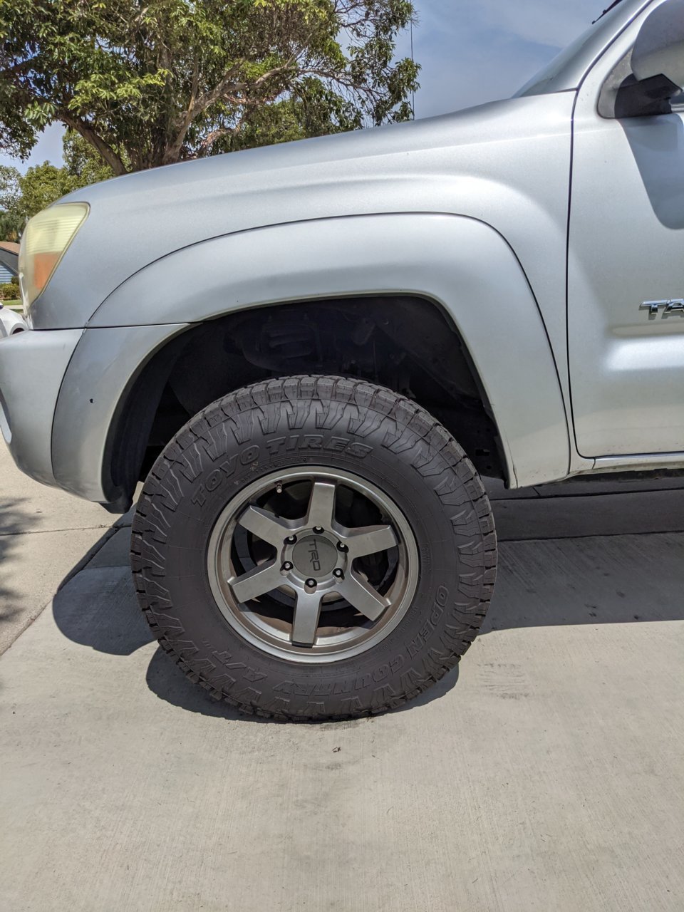

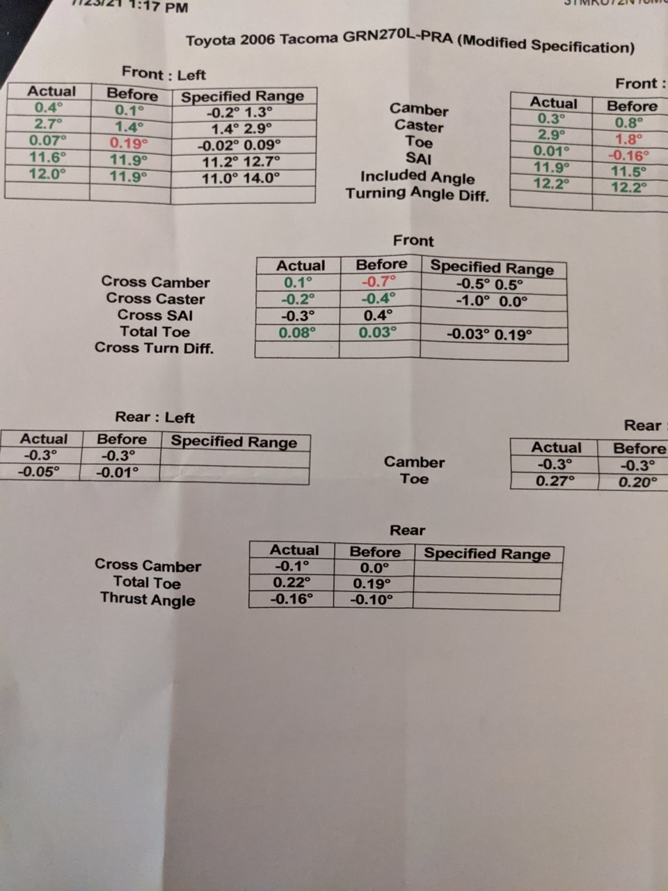

    They fixed it! No more rubbing. Pretty much back where I was before (a few posts up) with the Toe in a better spot
    33s 255s fit nicely. Next task... Restore the headlights

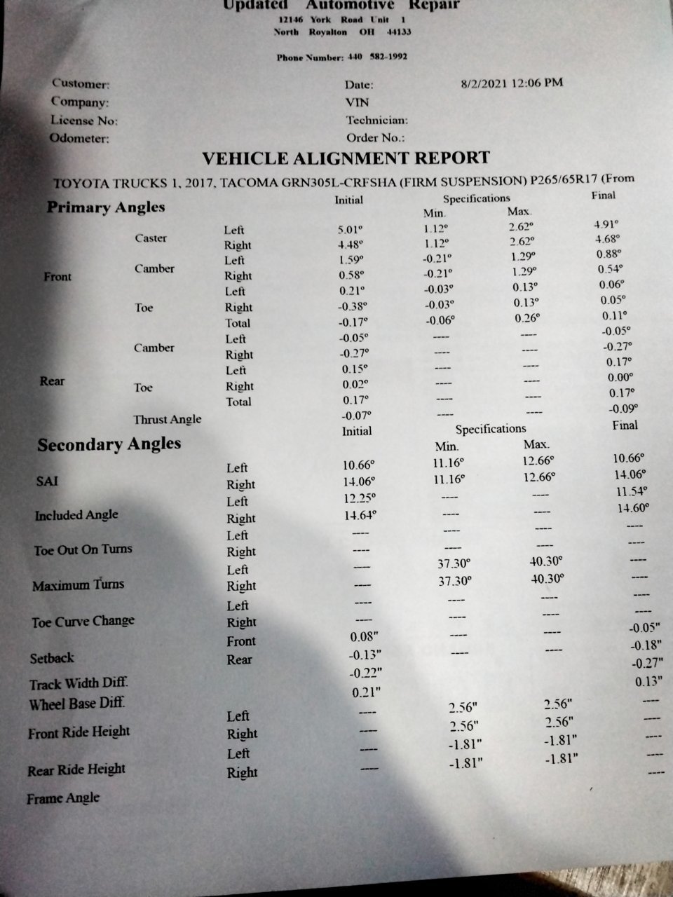

    I have spc installed, rides nice. Currently 265/75/16 going to 255/80/17s, steering wheel little crooked. IMG_20210818_132324.jpg
    Steve2580 and dirtnsmores like this.

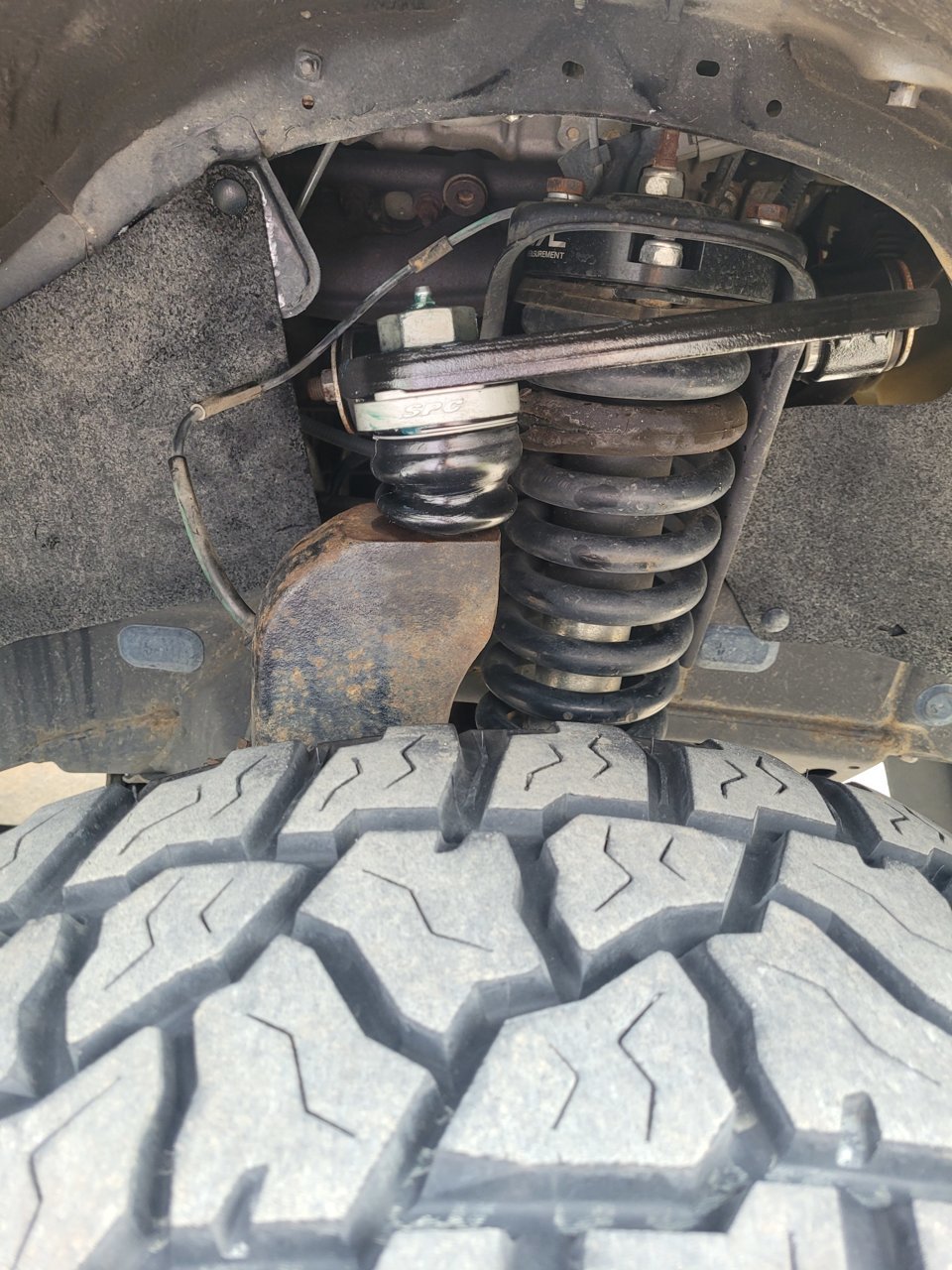

    post pics of your alignment cams.

    What are you trying to achieve? W/a 6" lift you don't have clearance issues like most who are dealing with with maxing out the eccentrics to get caster. They should be able to adjust the lowers to get your camber to 0. Your caster numbers should come down when they do that too, but they're not bad as is.
    Those toe numbers just look like laziness.

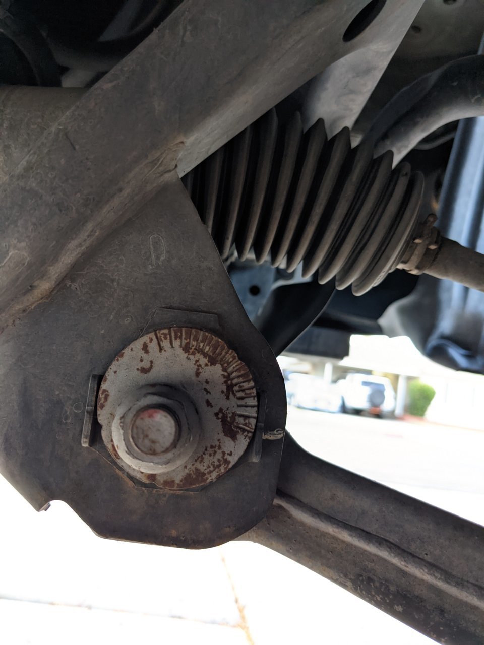

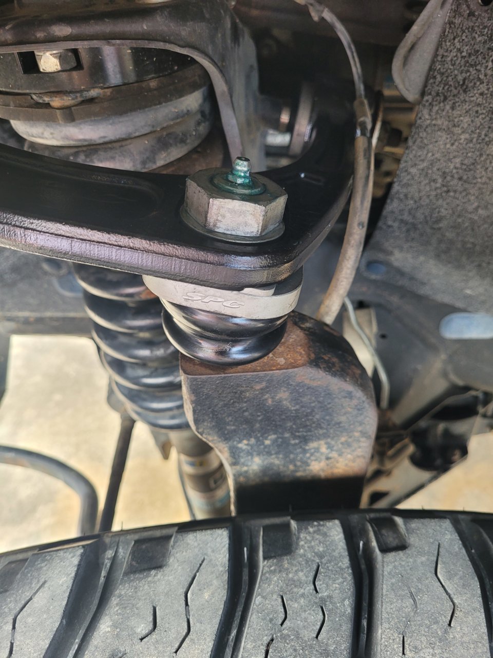

    All I really wanted to do was get my camber right, that's why I went with spc. But currently my cams I believe are at max camber and the spc is max camber and I'm still negative camber plus I rub now.
    With my caster setting as is currently I'm rubbing at reverse. If I reduce my caster to improve my camber, wouldn't that make my rubbing even worse?
    Or am i understanding it incorrectly? I appreciate the help man!
  12. Nov 24, 2021 at 10:37 AM
    #1272
    happyabortion
    happyabortion Well-Known Member
    Feb 22, 2013
    #98156
    197
    brian
    port arthur TX
    99 tacoma prerunner

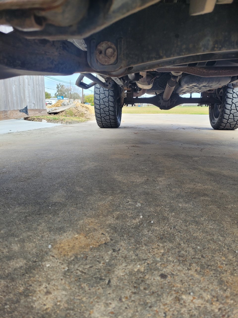

    Please excuse my crummy angles, I'm holding a 3 month old baby trying to take these at the same time lol.
    Passenger side

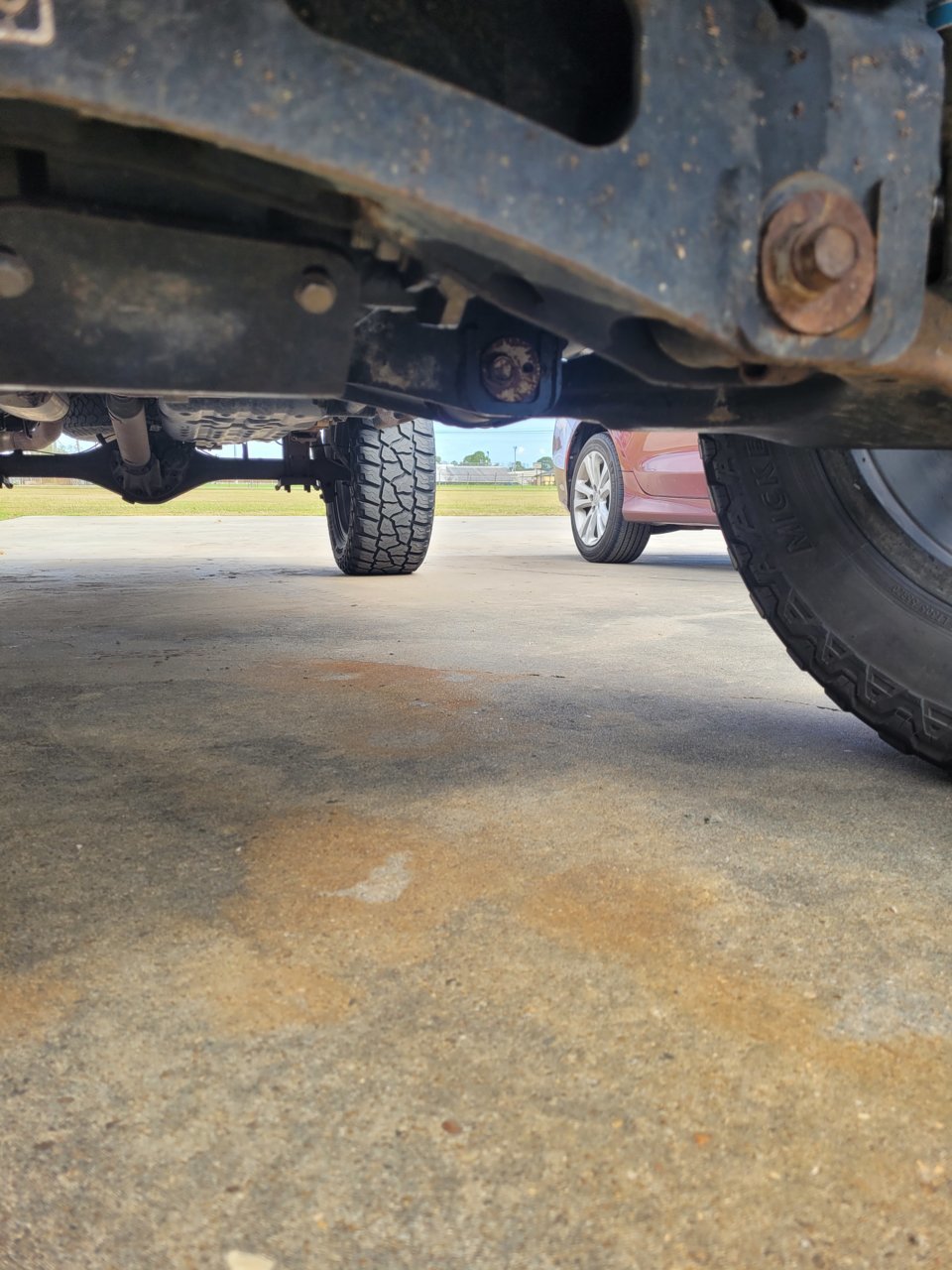

  13. Nov 24, 2021 at 10:37 AM
    #1273
    happyabortion
    Feb 22, 2013
    #98156
    197
    brian
    port arthur TX
    99 tacoma prerunner
    Driver side

    Rotate the rear cam 180 degrees so the cam is facing the other direction. Rotate the front cam 35 degrees counter clockwise so the thick part of the cam is pointing out towards the wheel. Mirror these settings on the drivers side. Once this is done then use the SPC for all camber and caster fine tuning.
