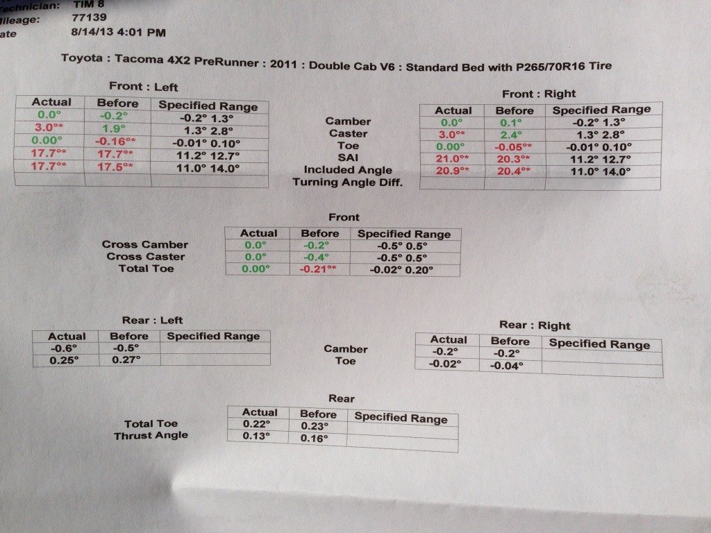

    Just got my truck aligned at Firestone, got the lifetime alignment. Kept the Eibachs with 5100s at 0. (w/spindles in front, 3" springs in rear).
    Asked for 0* Toe, 0* Camber and Closest to 3* as possible for Caster. And they got it exactly! Drives great. Kept the LR UCA setting at -1* (So total +1* in caster).
    Is the toe on the rear left tire an issue tho? Hm..

    That's odd. I see the front are both zero. If the steering wheel is straight as you cruise then the rear toe discrepancy is nothing to be concerned with.

    it shouldn't be, it cant really be adjusted. if the rear toe is way off your truck may track a little sideways lol, but a good alignment guy will compensate for that up front. I noticed that my rear toe was way off when I installed my dakars, I recently got another alignment about 6 months after I installed my leaf springs, and the rear straightened itself out, and my rear toe is a lot closer to 0 than it was. I wouldn't worry about it, since you got the lifetime alignment (which was a good call) go back in a few months after flexing out the rear and get another alignment, I bet it will be closer to 0

    Cool thanks for the comments on it not being an issue. It drives so great now, solid and straight.
    But this last weekend I put my motorcycle in the bed and towed a trailer with two dirt bikes and it has a very slight turn to the right. But now its perfect again.
    With firestone I guess it's a gamble. I first went to one near my work and they did not want to touch my truck because "they use the stock alignment specs and will not work for lifted/lowered vehicles....go to local shop that specializes...blah blah". Even though I said I don't have the common issue where people lift their trucks and want perfect alignment with stock UCAs...which I could understand they get crap for when guys crank up their suspension a lot and complain it doesn't align....
    Then I called the "local shop" and they said $90 one time and that lifetime alignments are a scam. :confused:
    Then drove to another Firestone in my town (that has new management) and they did the lifetime alignment no problem. I asked If I could recommend the setting I wanted rather than have them align it as they normally do (to stock ranges). I specified 0 toe and camber and the closest to 3 for camber. Spec sheet came out exactly as I asked.
    I didn't have firestone touch my UCAs or did I mention they can adjust. I just set the LR UCA to +1 setting (E) and the ball joints are set all the way out away from the vehicle. Picked it up without any comment on it not aligning and the spec sheet said just what I wanted.
    My truck rode fine before the alignment other than my previous bad tires and blown shock. Once I got new tires and set my alignment to where it was (I marked my cams before changing my shocks).

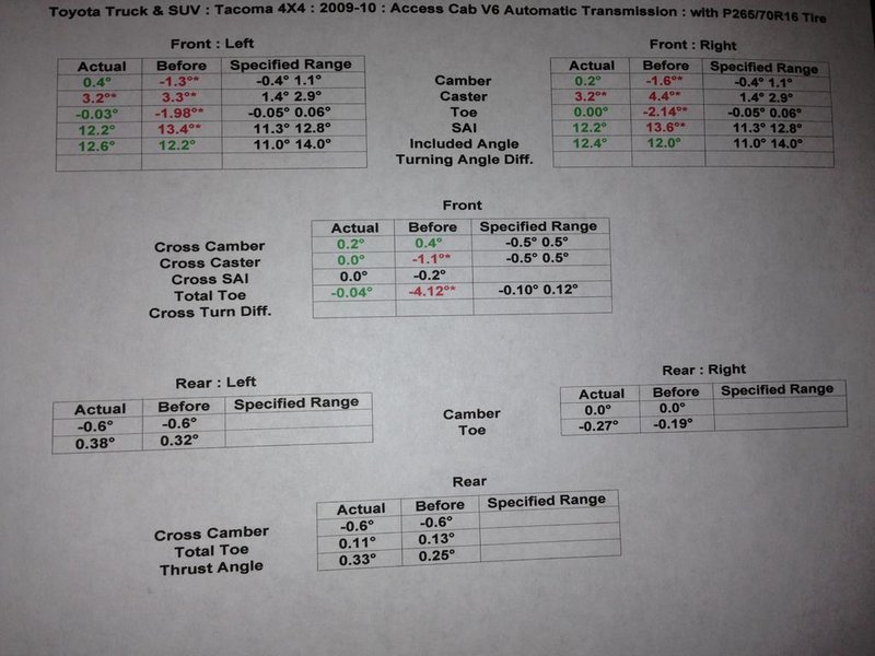

    Got my first alignment since LR UCA install today. Asked for Caster 3, camber and toe 0 - this is what Firestone came back with. How's it look? alignment.jpg

    How does it drive?

    Steering wheel is a little to the right when driving straight and it pulls hard right when letting my hands off the wheel. Ive had this same issue with stock UCAs and I took it to a different firestone and they corrected it, except for a slight pull to the right. My truck has always pulled right, but not this hard...

    Looking at the specs, you should not have a pull to the right. You may need to thoroughly check out some other components like the lower control arm bushings for excessive play.

    I think the steering wheel not being straight is because the toe specs are not equal. The front toe is the easiest thing to adjust on these so shame on the alignment guy for not getting it spot on. You could get down under the drivers side with a couple of wrenches and toe in the driver's side slightly. It's actually quite easy to do. You don't even have to take off the skid plate for that.
    The pulling to the right I think is caused because they changed your cambers from slightly negative to positive. That can cause a pull when you are on a slight slant like the crown of a road. You might want have them zero out the cambers.
