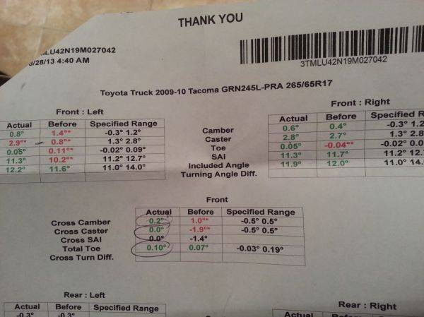

    At Firestone right now getting an alignment. (Which btw, lifetime is on sale for 139) told them 0 toe, 0 camber, and as close to 3 caster as possible. We will see.

    They apparently had two newer guys workin on it. The kid asked.. is this all aftermarket? No.. new UCAs, shocks and coils. He replies with... why don't you have new spindles. Dont you need them. With the most confused look. Needless to say.. after 2 hours they couldn't get it where I wanted at 0 camber 0 toe and 3 caster. They got it to driveable.. and I have to go back today so a more experienced tech can do it. I should them this thread and everyone's numbers.. we will find out today.

    ok, here it is.. numbers came out great. Camber might need a tad of adjusting.. other than that, the vibes i was having and alignment issues of the tires catching the rear of the fenders.. have been fixed. now tho.. they grab the front of the fenders.. just gonna have to trim. no biggie.

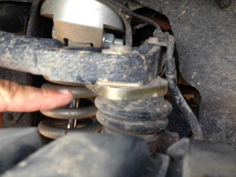

    According to this photo and what adjustments setting are from SPC. What degree is it sitting at. It looks way off.
  18. Sep 16, 2013 at 7:48 AM
    #178
    XPOTRPR
    XPOTRPR CNC Programmer/Machinist
    May 29, 2011
    #57449
    31,171
    Josh
    Chandler, AZ
    > BUILD LINKS >
    Looks like the +1 setting

    +1 setting for 3* added caster? I hate how they make it confusing. Looks like +3 to me
    Edit: nevermind i was all turned around. Looks like +1 total, ^ your'e right

    Actually .. I WAS looking at it like it was the +3*. YOU are right sir. :thumbsup: lol.
    If it is that, that might be off. Mine is set to +1... totally of +3*
