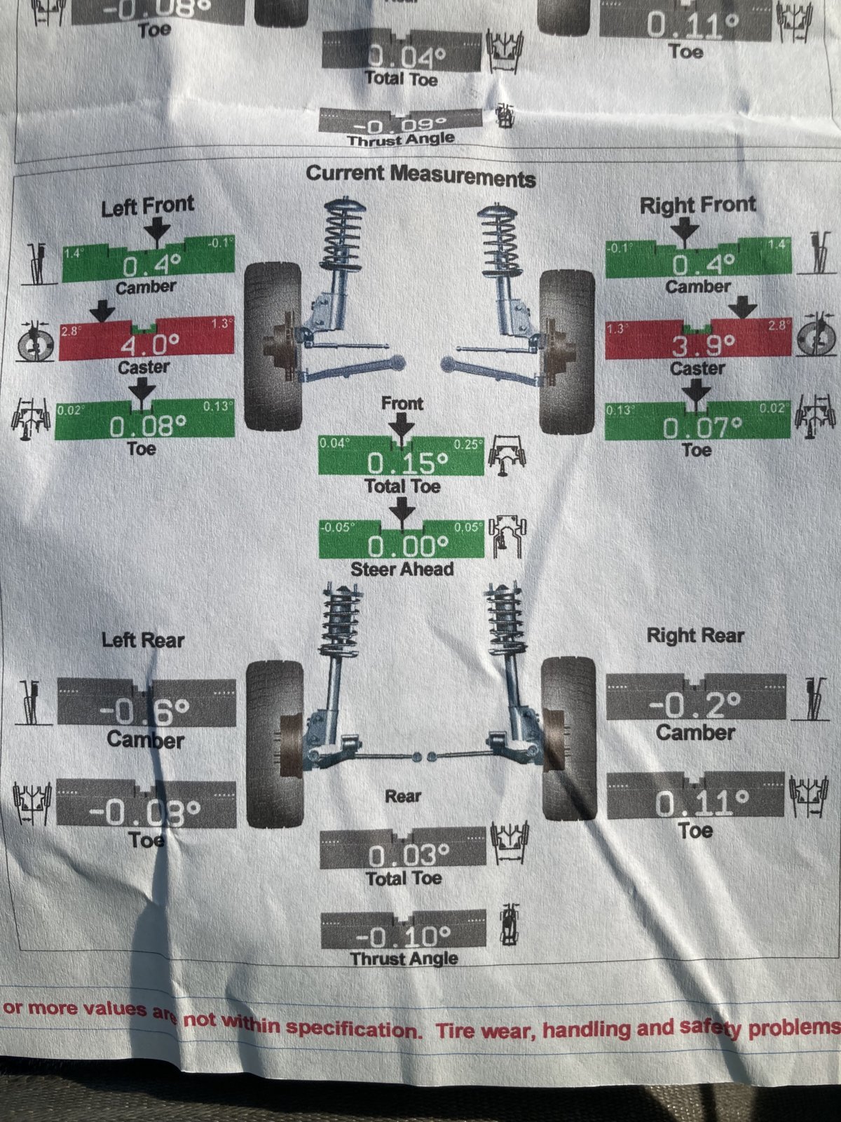

    I jut had new UCA’s installed. Do these figures look ok?

    More info pls, stock? lifted? what are your wheel and tire specs? That's a lot of caster which is good for drivability if you need it to clear potential rubbing.

    Pretty good. From experience I'd probably go a touch lower caster and a touch higher camber, but this is basically perfect for a lifted truck. It will drive a lot nicer now.

    Running a 3” lift with 265x70xr18 tires on stock rims w/ 1.25” spidertrax spacers.

    Your specs are top shape for that set-up, stock UCA or aftermarket?

    Rough country UCA. I wish I would have done UCA when I did the lift.

    4 degrees is perfect after a lift and aftermarket UCAs. 3-5 is the new green, but dont go over 5.
