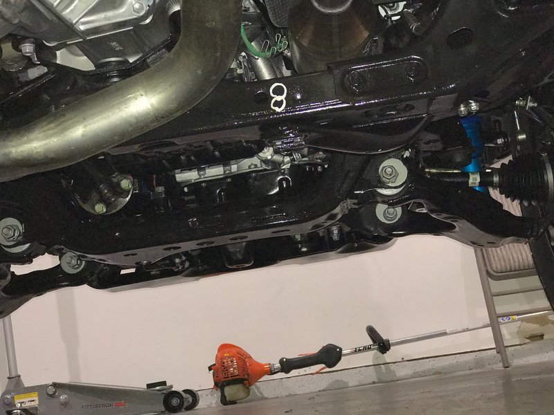

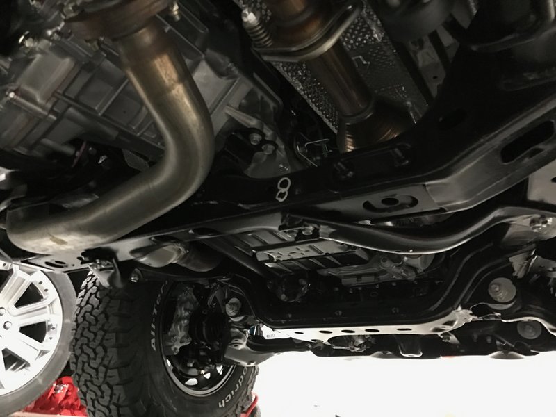

    Couple pics of the rear cam bolts

    Uhhh....either I'm crazy or not seeing something right, but I have no idea how you have so much caster, your caster cam bolts are opposite of what they should be

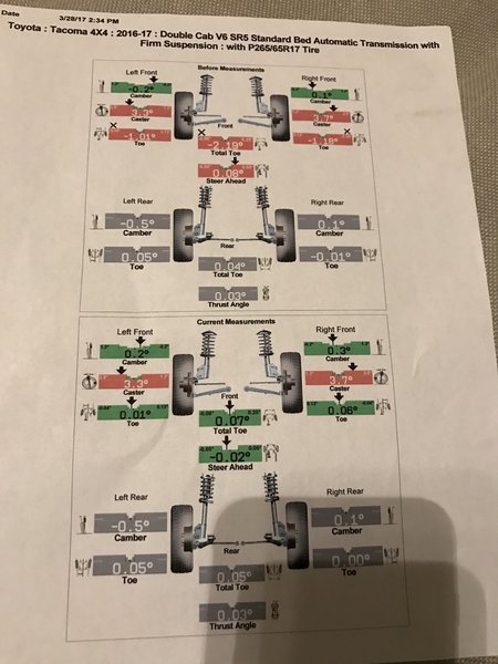

    I have no idea. :) . If I look at their sheet, honestly the only thing I see that they changed from what it already was was the toe and steer ahead. There was no change in camber or caster now that I look at it. Camber was already in "factory spec." so they may not have messed with the LCA at all.

    There's no way you should have that much caster with the cams like that....with the cams like that you should have like 1-2* max

    3" almost exactly. Here's a pic of their sheet.

    That's weird. Like anthony250f said, just by looking at your cams you should have a lot less caster than your print out shows. On the plus side though, there's still room on the rear cam bolts to push the wheel more forward to help with the rubbing issues. But who knows what effect it will have on camber/caster with the weirdness going on with your cams.
