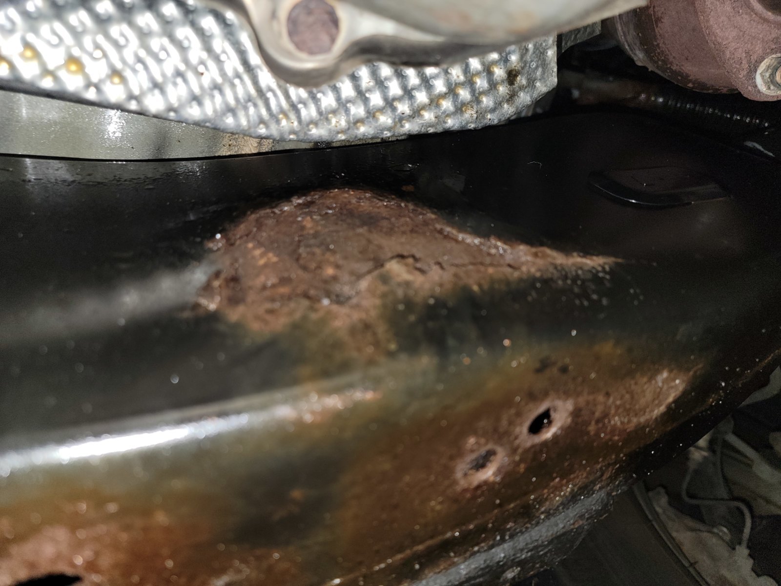

    The frame on my 2010. The truck had 59,000 miles on it. I've decided Toyota is Mexican built scrap metal

    that damage is caused from neglect. It’s not a Toyota issue. I’ve lived in and out of rustbelt states all my life. If you don’t treat and clean your undercarriage and frame, this will happen to any damn manufactured vehicle. It’s not a Toyota only thing.
