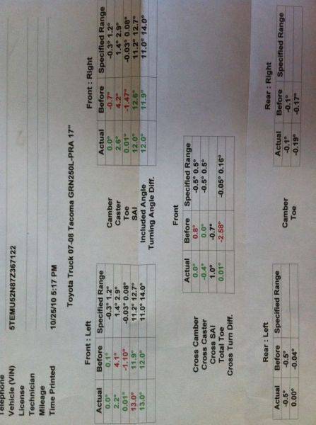

    So I got my alignment done and it is really nice, but Im having a really bad issue with rubbing on the body mount. I know i need it choped, but for now this is my issue. On the right side it isnt rubbing and my caster is 2.6 but on my left its rubbing at 3/4 lock and its 2.2. I went down to the place and the guy said they would adjust the left side to 2.6 but it would make my truck pull right on the road. they say the right side should have more caster because the roads are crowned. I need to do something to stop this rubbing before i get it chopped. Any advice.

    oh and I found a local shop like 2 minuites ago to do my cab chop but the soonest they can do it is a week, should I just tough it out for a week and avoid any u-turns?

    Well, I would just tough it out for a week. Be by before you know it. The Alignment specs are really good. No point in wasting money getting it re-done if you are gona do the body mount chop right away.
