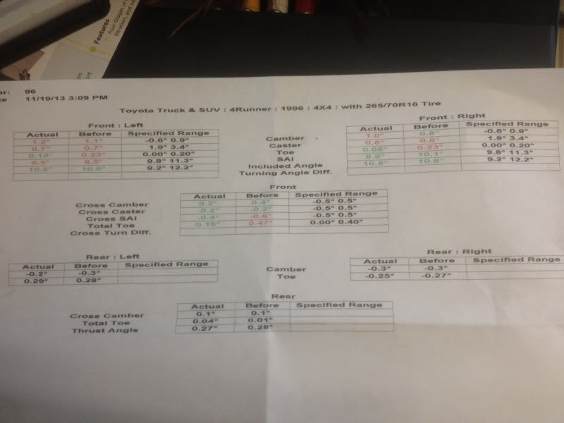

    I took my car to firestones for alignment today to get my alignment done. After the alignment my tires still have positive camber, it looks like this \--/. Does anyone have a solution for this? I have TC UCA and donahoe coilovers.
    Here is the result.

    Did they say anything to you after the alignment? They adjusted somethings but I wouldn't say they really aligned it... Almost everything is still out of spec. Looks like all they did was fix the toe and they didn't even improve that much...

    Both firestones told me that they can't get the camber back to spec and yeah all they did was adjusting the toe. I'm really frustrated with firestones right now, it only take them about 15-20 mins to do my alignment and this lifetime alignment is BS IMHO.

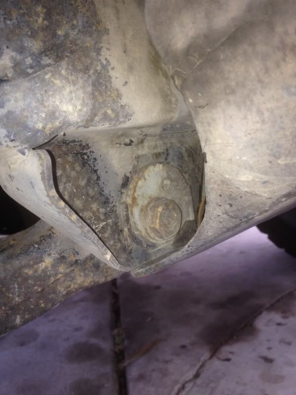

    Did they say why? Are your alignment cams seized?

    Both shop blamed it on the lift and aftermarket parts... How do i check to see if my alignment cams are seized?

    Looks like they just don't want to mess with it. They could definitely improve on that! Caster is almost non existant bet it wanders everywhere on the road. I could do better with my iphone angle app or even just by eye!

    You can try to loosen the nuts just a bit and turn the other side but you will mess with the alignment if u do that. You prob couldn't turn them without the tires sitting on turn plates though.

    Loosen the nut on the cams and then try to turn them.

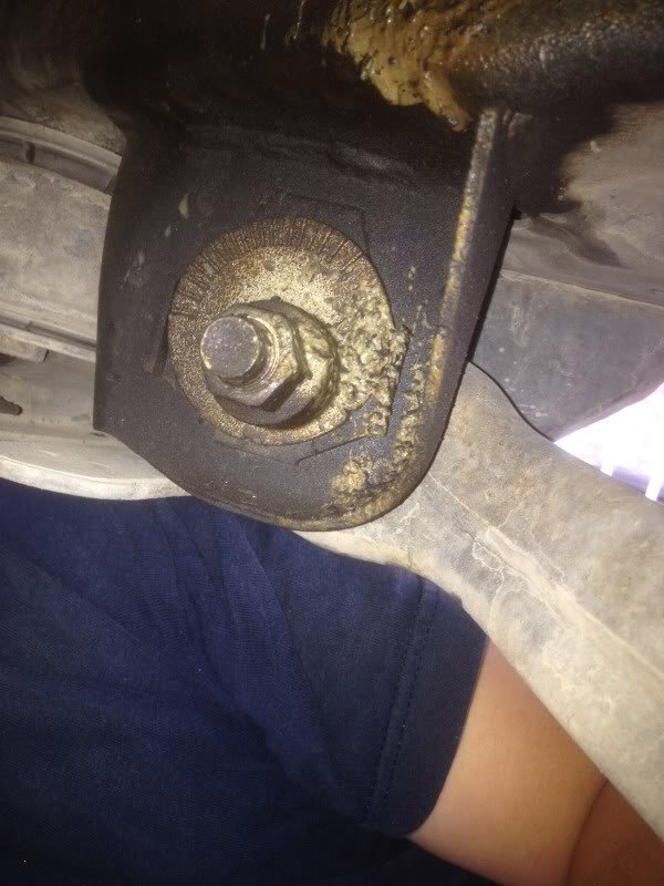

    Are the front cam bolts sitting to the outside of the truck with the majority of the washer facing the inside?

    Go check your cams real fast bud.

    I dont think they touch the cam bolt because all the CV grease are still there LoL
