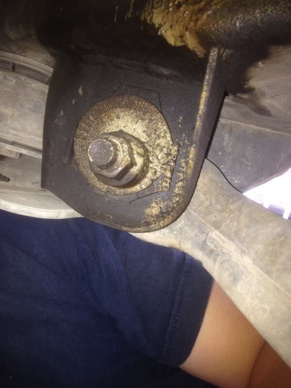

    I added 2 pictures so loosen the rear nut and adjust the front bolt? Because mine doesnt look the same as the one from braddy's picture

    is this from the front or rear?

    It's on a 2nd gen...
    In this pic:
    Is that nut attached to the cam tab? If so you just need to try to turn it.

    no it doesnt attached to the cam tab but i will try tomorrow
