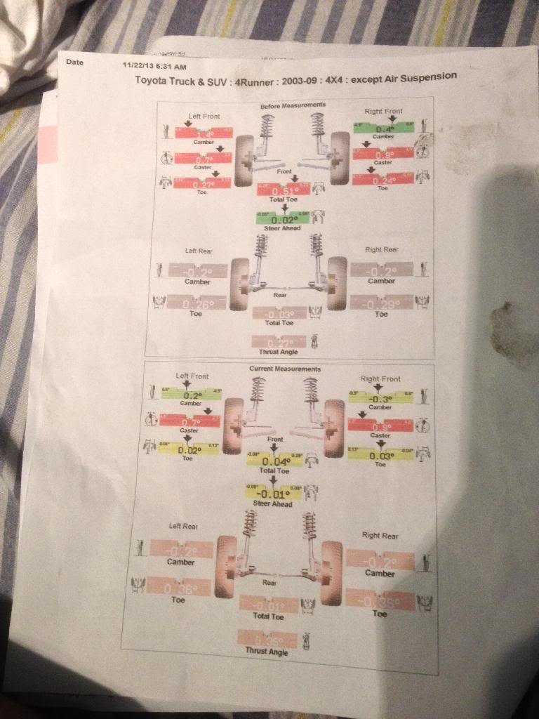

    Took my car to firestone today for the alignment again and this time I specific ask one of the tech to adjust the camber angle and he got it pretty close to stock spec but he doesn't know how to adjust the caster angle. He spent about 1 hour to do my alignment and I'm still not happy lol. How do you adjust caster angle? so I don't look like a fool next time i take my car to firestone.

    Here is the result, this guy put alot of effort so i gave him a tip lol

    on a cam system, the camber/ caster are dependant on eachother. when you adjust one you adjust the other. Wow! can't believe this person has peoples lives in their hands! Their alignment system even tells them how to adjust it! By this lack of knowledge, get a refund! The second guy did an ok job, but if there was that muck camber improvement from the first time, they had room to get the caster closer.

    Those toe and camber numbers are much much better than before!! Caster is a low, but how does it drive? If you are happy with how it drives then I wouldn't worry about it. Camber and Toe will eat your tires, Caster is mostly for how it drives.

    you need more caster, that can be achieved by adjusting the LCA first, bring the front of the lower control arm in towards the motor and the back out away from the motor, that will give you more caster, you want to see at least 2.5 on the caster, a little more helps even more and will stabilize the bump steer and make her drive like a dream on the freeway, you will brake much straighter too...you may have to 'guide' the tech a bit...
    then the camber and final caster adjustments can be done with the UCA. The toe will need readjusting and is the last thing to be done (centering the steering wheel is also done with this adjustment), usually takes two go rounds on all of the adjustments before it is properly fixed...
    your end figures should be like this.....
    Camber 0*
    Toe 0*
    Caster 2.5* or a bit more

    Yes report them and ask corp for a refund! Don't take it back, just cut your losses and find a local shop not a chain! You don't want them messing with your baby! They have already proven they don't know what they are doing, they even admitted they don't know how to adjust it! I can't really explain how to adjust without showing you. When you adjust one cam you have to keep an eye on everything all at the same time. It's not hard just confusing to explain. Get two wire hangers and look at them like the control arms. You want both tips(where the ball joints would be to be parallel aka. 0 camber) but at the same time you want the upper hanger/control arm aka. top ball joint more to the rear roughly at 2.5 degrees measured from the bottom ball joint.

    It pulls because they didn't get the caster split right the passenger side should be roughly 1/2 a degree higher to fight road crown.
