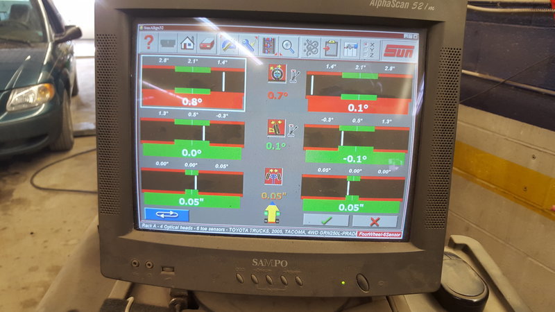

    Just got new rims today, for whatever reason truck started pulling to the right big time, went to get an alignment from local shop and apparently the alignment was indeed off (on the right side at least). After watching the guy take a torch to some stuck bolts and cussing and hammering away at something he ended up with these numbers, is this okay or are my tires going to shred themselves lol, I'm not familiar with alignment #s....
    truck has 1.75" bilstein lift with stock size tires, stock UCAs obviously

    Yikes! Thats caster/camber. Your tires aren't going to ride flat and even that's for sure.

    Your caster is way low. Tires will wear fine but you'll be struggling to keep truck in lane flying down highway. Only real way to fix this with that lift is adjustable upper control arms. Can't dial in enough with factory. Sorry

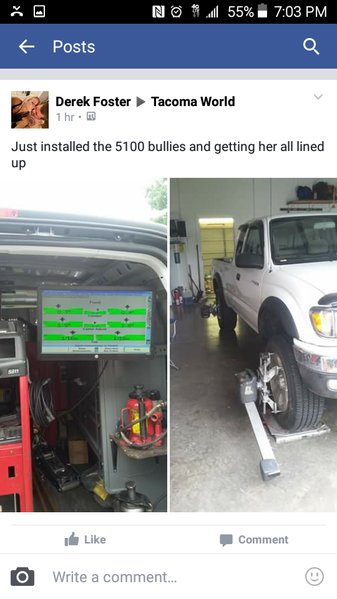

    Screenshot_2016-04-15-19-03-20.jpg just did 5100some today and dial her in just fine u have other issues

    Agree caster is way low. I have Billy's with OME 885s and was able to 2.4 and keep decent camber. Stock UCAs.

    Agree but caster that low will wander and grab every imperfection in the road - call it twitchy I guess. That's what I found post-lift. Can't imagine twitchy being anyone's style!
    To your point - I was told get 3.0 caster but couldn't get there with stock UCAs. 2.4 worked for me and had a way better feel than the -1 pre-alignment. Good point on the road crown adjustment. I need to go back and have mine tweaked a bit as I have a bit of occasional drifting. .2 sounds like it might do the trick.

    I would honestlyrics buy some new camera bolts replace ur lcaster bushings get the the u case for sure if u can afford them I just can't afford them now I will be getting them and the HD coils when u get my bumper built and winch as long as u can get ur caster above 1.5 driver and 1.7 passenger u will be good for a while

    well, got light racing ucas in and ome 885s
    new alignment numbers from today are..
    caster 2.9 and 2.8
    camber 0.8 and 0.6 -_- is this "really" bad?
    toe 0.05 and 0.05
    so my question is, is .8 positive camber way too much considering the aftermarket ucas
