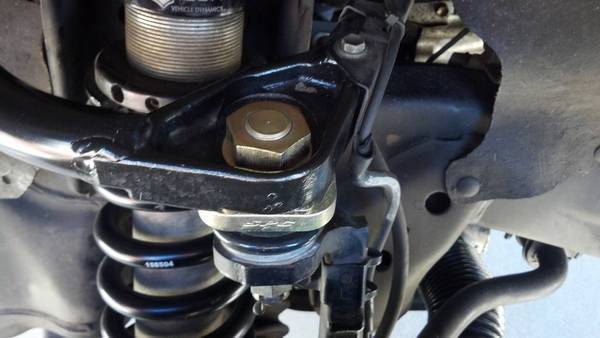

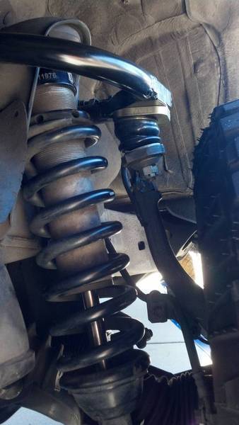

    Ok I checked everything. Shock tower looks fine....not an imperfection anywhere. She lower shock mount on the lca looks fine also. Everything looks fine as far as I can tell. I adjusted the passenger side coilover 1/4 of an inch so the truck is perfectly level. The pics I am posting are of the drivers side with the truck jacked up. Only thing I noticed is that the drivers side wheel looks like it sits further back to the pinch weld area than the passenger side? IS this normal?

    Man. I feel your pain. I wish I could help here. I had horrible camber issues when I installed my lift. My problem was the Uca ball joint. Yours looks good to me.

    My buddy had a set of these installed on his Tacoma and the only thing I THINK I see is if you look at the UBJ and especially at the "brass" colored piece with the SPC stamped on it, it looks like it is 180 degrees off. I believe that the plate can face either way, but only is correct in one direction. I may be wrong, but I seem to remember noticing that when we were installing my buddy's lift on the front. Worth a look-see!

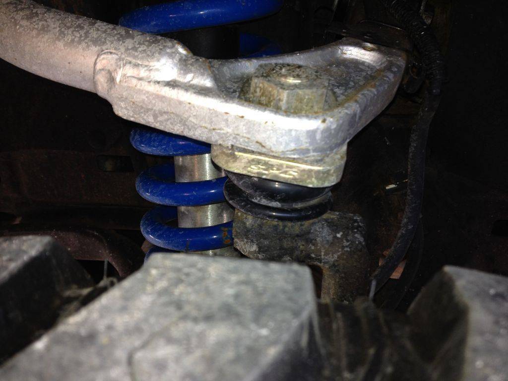

    This is where my driver side ubj sits. Looks to be in the same position as yours.
