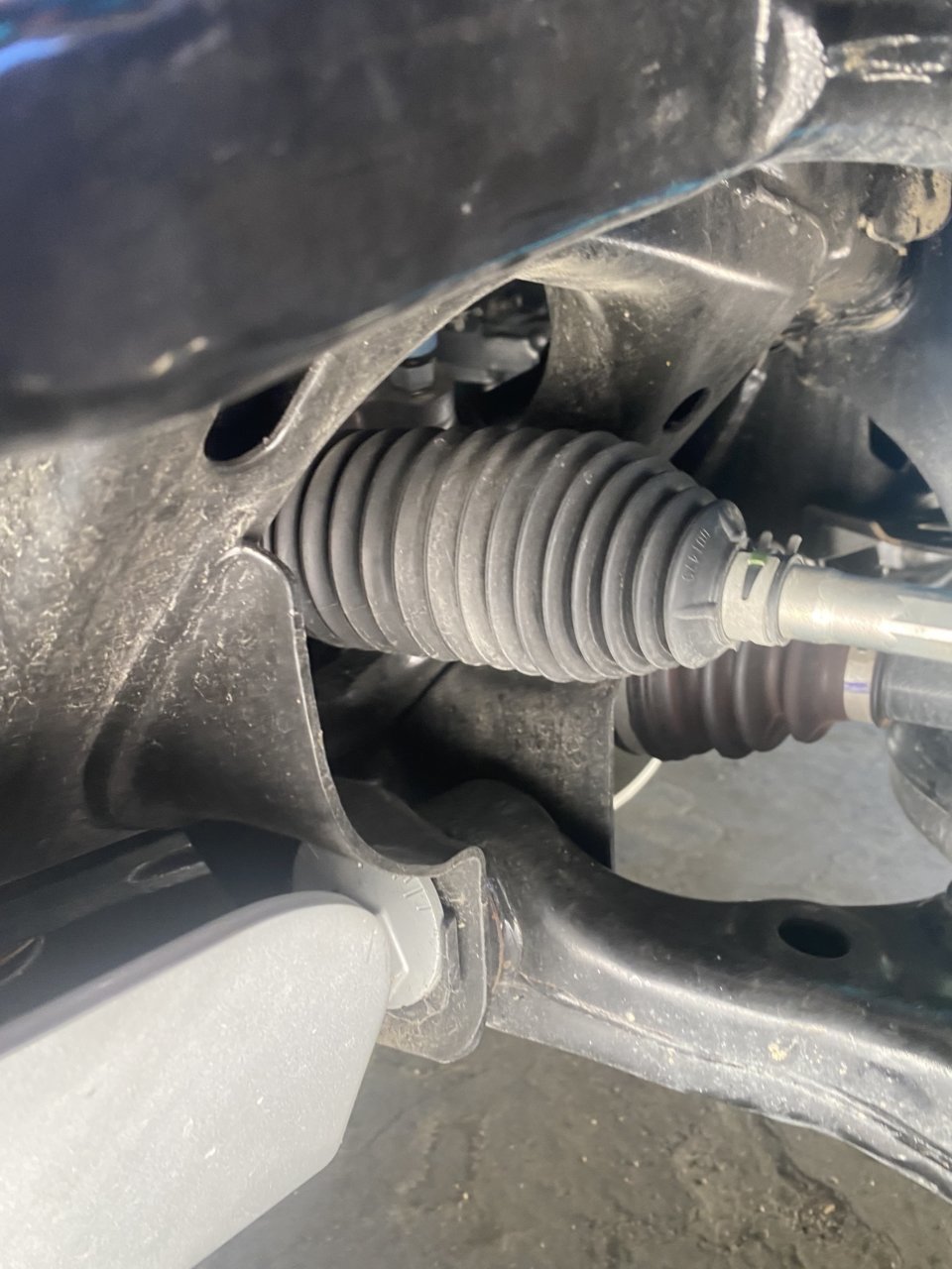

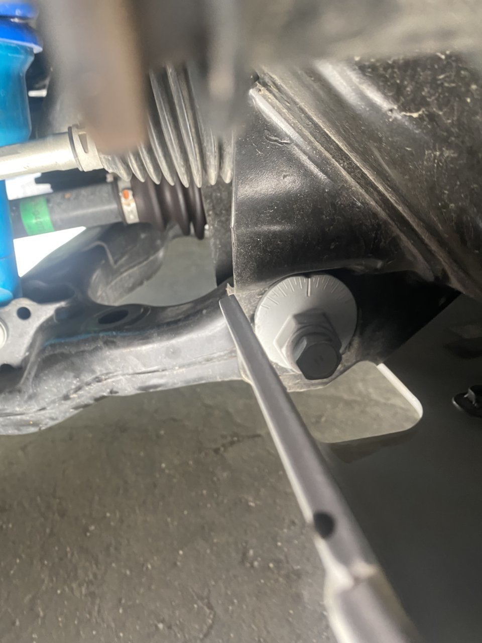

    Might be worth noting I have a skid plate on and it looks like they'd need to pull that off to access the alignments cams.
    First photo is passenger side, second is driver side...
