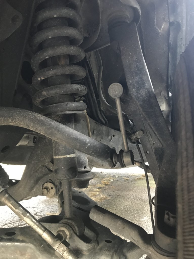

  13. Oct 16, 2017 at 11:00 AM
    #53
    Justinlhc
    Justinlhc Not looking for a relationship
    Jul 7, 2015
    #158945
    3,512
    MaxTrac spindle lift tierod:
    RexsTaco likes this.

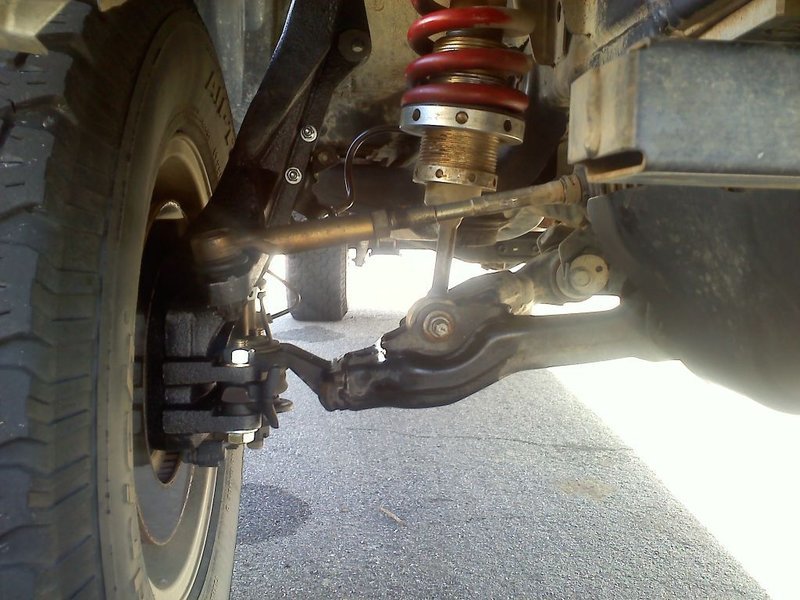

  14. Oct 16, 2017 at 11:01 AM
    #54
    Justinlhc
    Jul 7, 2015
    #158945
    3,512
    Op’s Tierod:
    dylan.passera[OP] likes this.
  15. Oct 16, 2017 at 11:03 AM
    #55
    Muddinfun
    Muddinfun Well-Known Member
    Apr 17, 2017
    #216500
    7,489
    Maybe whatever ching chong spindles the OP has doesn't do it like the MaxTrac. Personally, I wouldn't run any spindle on any vehicle that had enough slop in the hole to put the tie rod ends in either way.
    Toyko Joe and dylan.passera[OP] like this.
  16. Oct 16, 2017 at 11:10 AM
    #56
    Justinlhc
    Jul 7, 2015
    #158945
    3,512
    They do and if you don’t you end up with the exact issues he’s having.
    Op, flip the tierods, get it aligned. Fixed.
