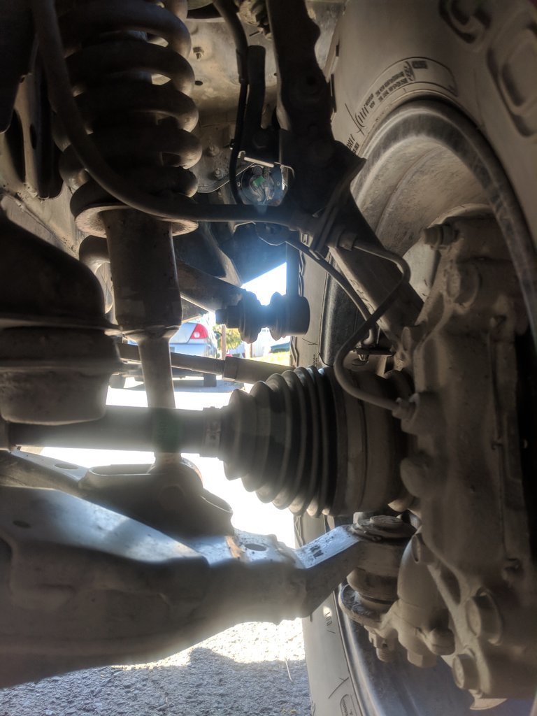

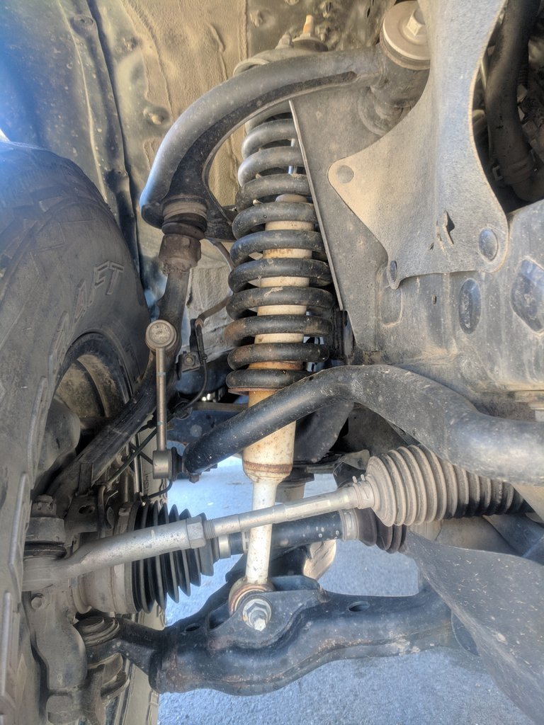

    Everything looks decent, factory upper and lower control arms, factory spindles, but the shock/coil look aftermarket. Might be rancho brand due to the white so possibly 2-3” lift if that

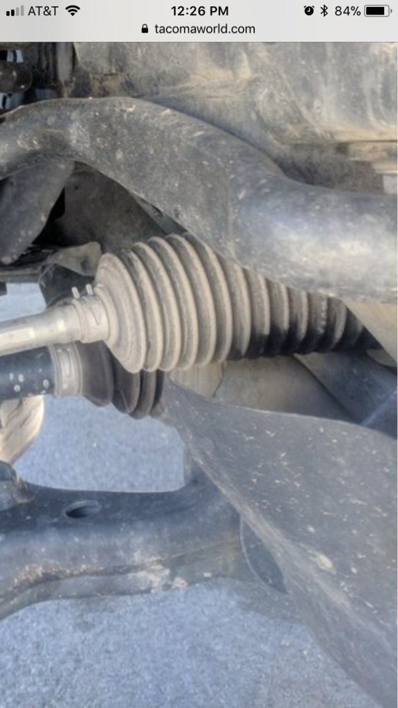

    Your inner tie rod boot pictured appears to be leaking power steering fluid slightlyFBF91532-CD9C-4C93-925C-B203E0F44B3F.jpg
    As far as alignment goes, the hub needs checked for play, same with ball joints and inner/outer tie rods, and someone that knows what they are doing needs to align it properly, none of that “set the toe and go” bullshit like a lot of places do

    Yeah looks like a shock is extended more than normal but any GOOD alignment place should get it straight. The lift doesnt look extreme so it should be easy

    It is 4x4. Its maybe a 2.5in lift is what I assume.

    Lifted or not your tie rod and ends have the same angel mine had prior to flipping them and that canceled out my slip steering it's a quick fix if that is the issue

    Not the best lift but they work, socks aren't as good and can fail sooner than OME, fox, icon, and king. From your issues and being a 4x4 it sounds like you need a proper alignment possibly new UCA to help adjusting. As far as the breaking issues you could have a sized piston in your caliper not giving you the full breaking power, best to check your pads and see if they are wearing uneven or if they need changed. Breaks could also need bleeding

    Please stop @dylan.passera ....you had a different lift. Flipping the TRE is for spindle lifts.
