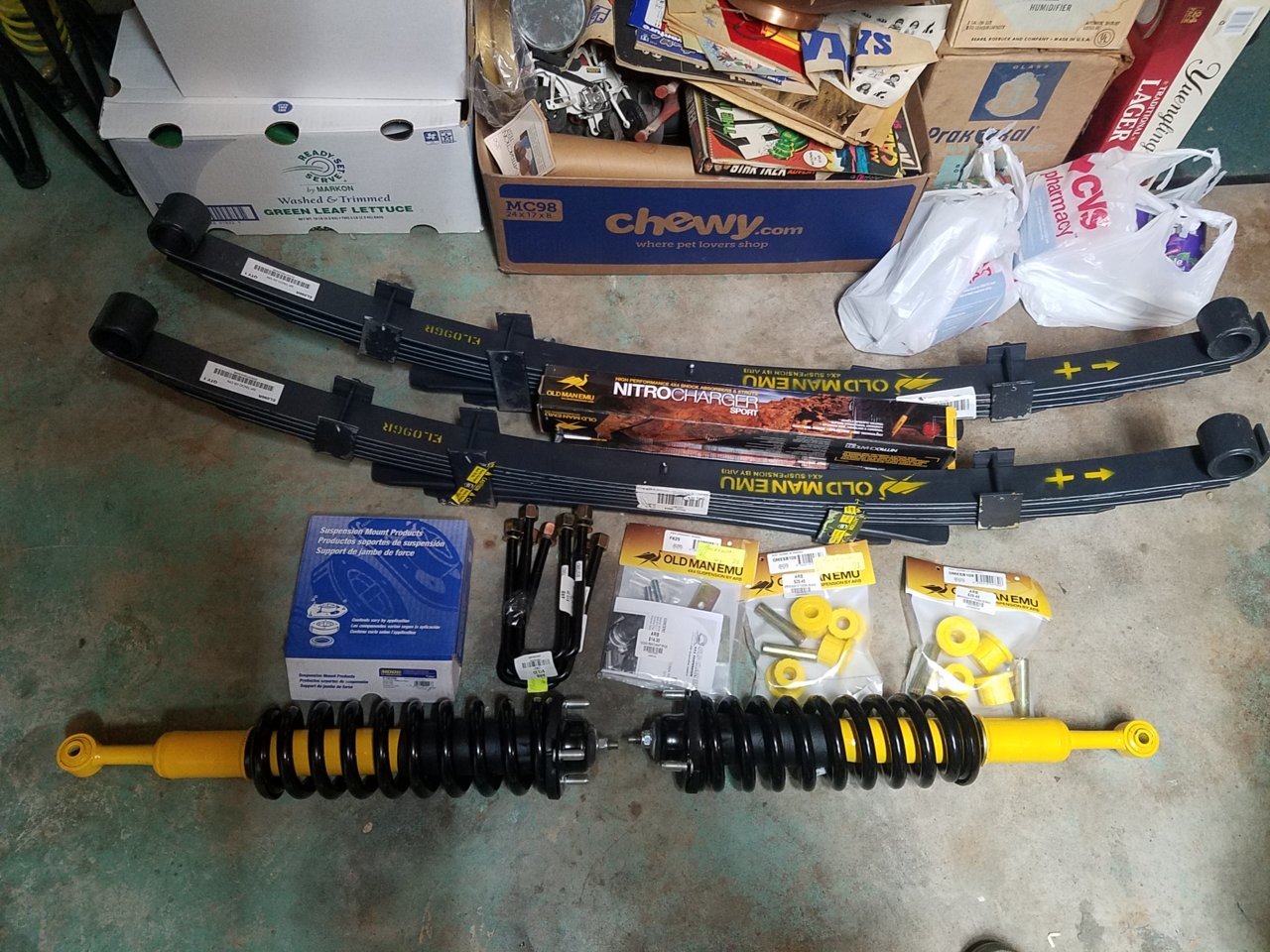

    Definitely will look into it more and see what I find. When you did the ome lift did you guys use the original leaf spring shims?

    So you didn't use any and your pinion angle was still good?
