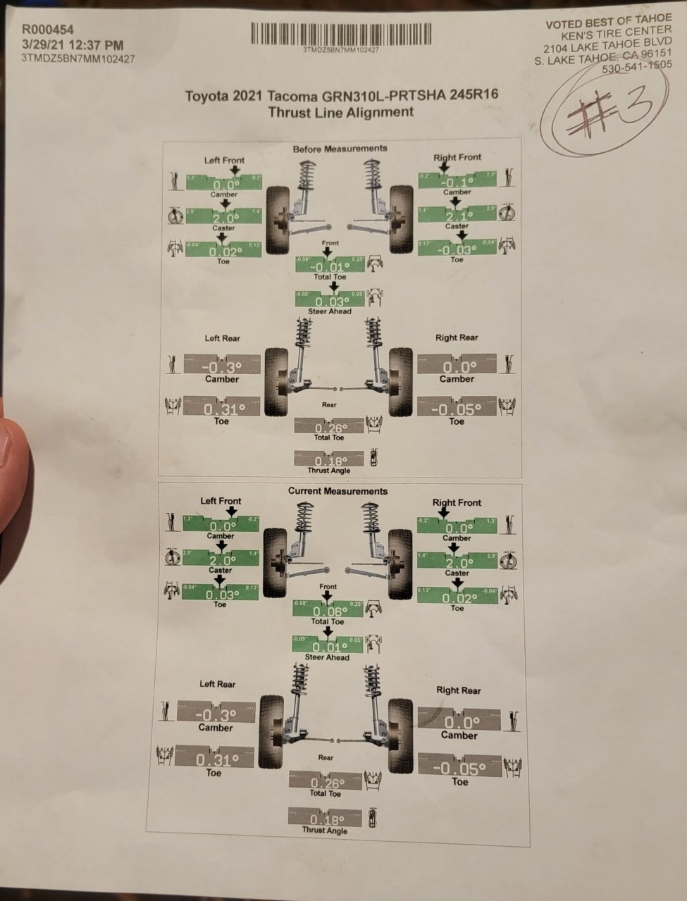

    Do you have a print out of the alignment?

    This is after the third alignment

    Do all your alignment sheets have the same info?
    Do you have one with SAI or included angles?

    I have the second printout, not the first.. They keep changing very small things only on the right to try and push it left. I'll upload the second when I get home

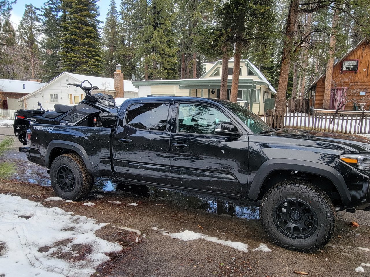

  17. Apr 19, 2021 at 4:00 PM
    #17
    Nyx
    Nyx [OP] Active Member
    Apr 19, 2021
    #363187
    33
    2021 Tacoma TRD Offroad
    Wheels Lightbar Tail lights

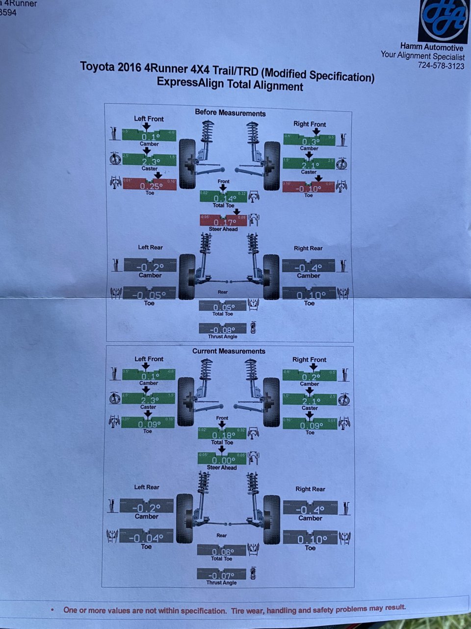

    Heres a pic of the alignment sheet from my wife’s 4runner after I lifted it and added 285s. The numbers are super close...you think yours would be fine as well. Damn the saga continues...
