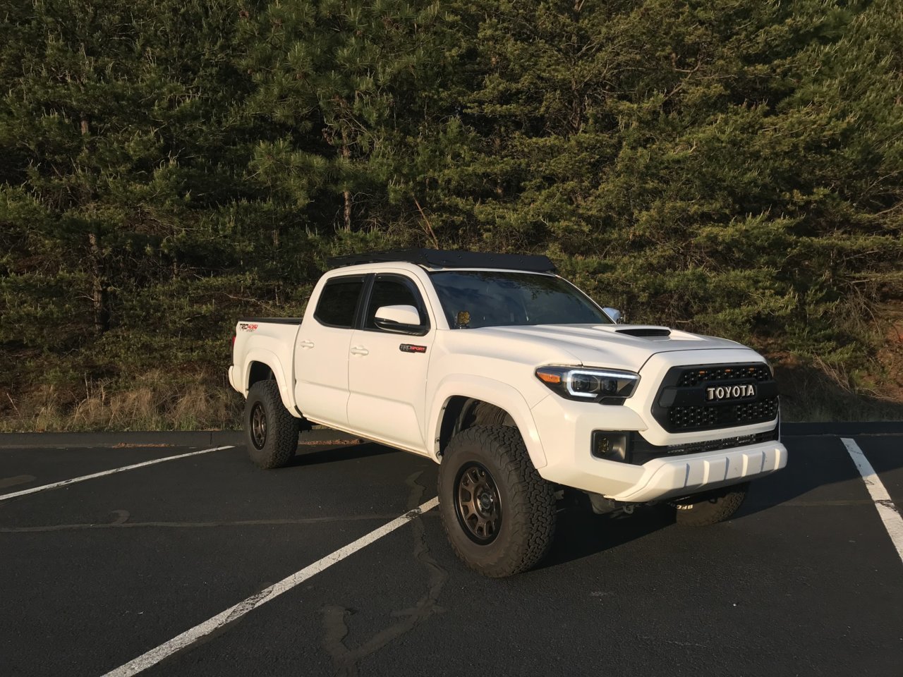

    Im running the same wheels (mine are 16x8 -12 though) and I have a similar tire. No issues before my lift and no issues with alignment after the lift either.
    only a 1.5 inch suspension lift

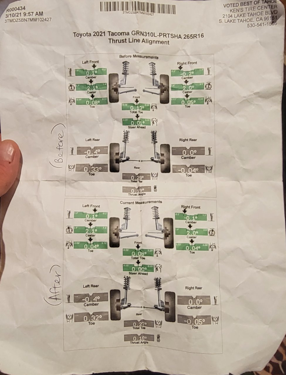

    Did alignment for a bit. If the specs are good, then you are good. You do not need an alignment after new tires unless your old alignment was messed up.
    as long as all the rims are the same size and offset, they won’t make a difference. No matter what offset it size.
    Most likely your issue is the tires. Had lots of times where people come in with cheap tires and the car pulled to the right or left. We would swap sides in the front of the tires and the issue went away.
    So my bet is there is an issue with your tires.
    look up ST maxx tires that people run on this forum. A lot of them also complain that their truck pulls to one side with those tires as well with perfect alignment.

    Thanks, it's not horrible but as soon as I let go of the wheel it starts to fade. But as everything is new, I was hoping there would be a solution for it. The shop has the put the PSI at 40, 45, 49 to test. No major change. It's set around 45 right now.
    Going to see if they have done a road force balance and if that doesn't do anything might try different tires. The shop is at least being nice and said I could test another set of tires.

    The 2 alignment print outs are all the info I have

    It's not enough info to confirm unequal scrub.
    Looks like they're just doing a toe-n-go and making no attempt at a "4-wheel thrust line" alignment; not to be confused with "total 4-wheel" alignment.
    Cooper radial pull is also a possibility.

    Yep, same shop that I bought the tires is doing the alignments. There doing the them for no extra cost so it's hard to pass up. I was hoping they would do a proper job. They are suggesting the rims offset is doing it but I don't feel they're the issue. I have an appointment with them tomorrow, I'm hoping they didn't do a road force balance previously and that fixes it.. Or try different tries as they said I could try some different ones. If that all fails then I'm definitely going to get an alignment done at a different shop.

    What do I need to get the extra info. The "4-wheel thrust line" alignment??

    **UPDATE**
    The shop had done a road force balance, twice, so unfortunately that wasn't the fix. Just to make sure it wasn't something with the truck we put the stock tires/rims back on, annnnnd it went straight.... so the next step to fixing the problem is different tread/tire. New tires ordered and going to install Friday.
