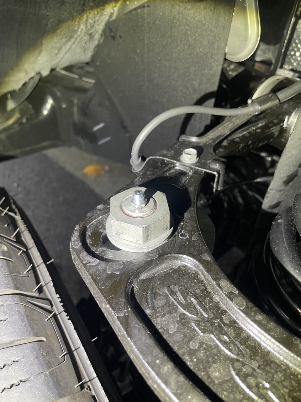

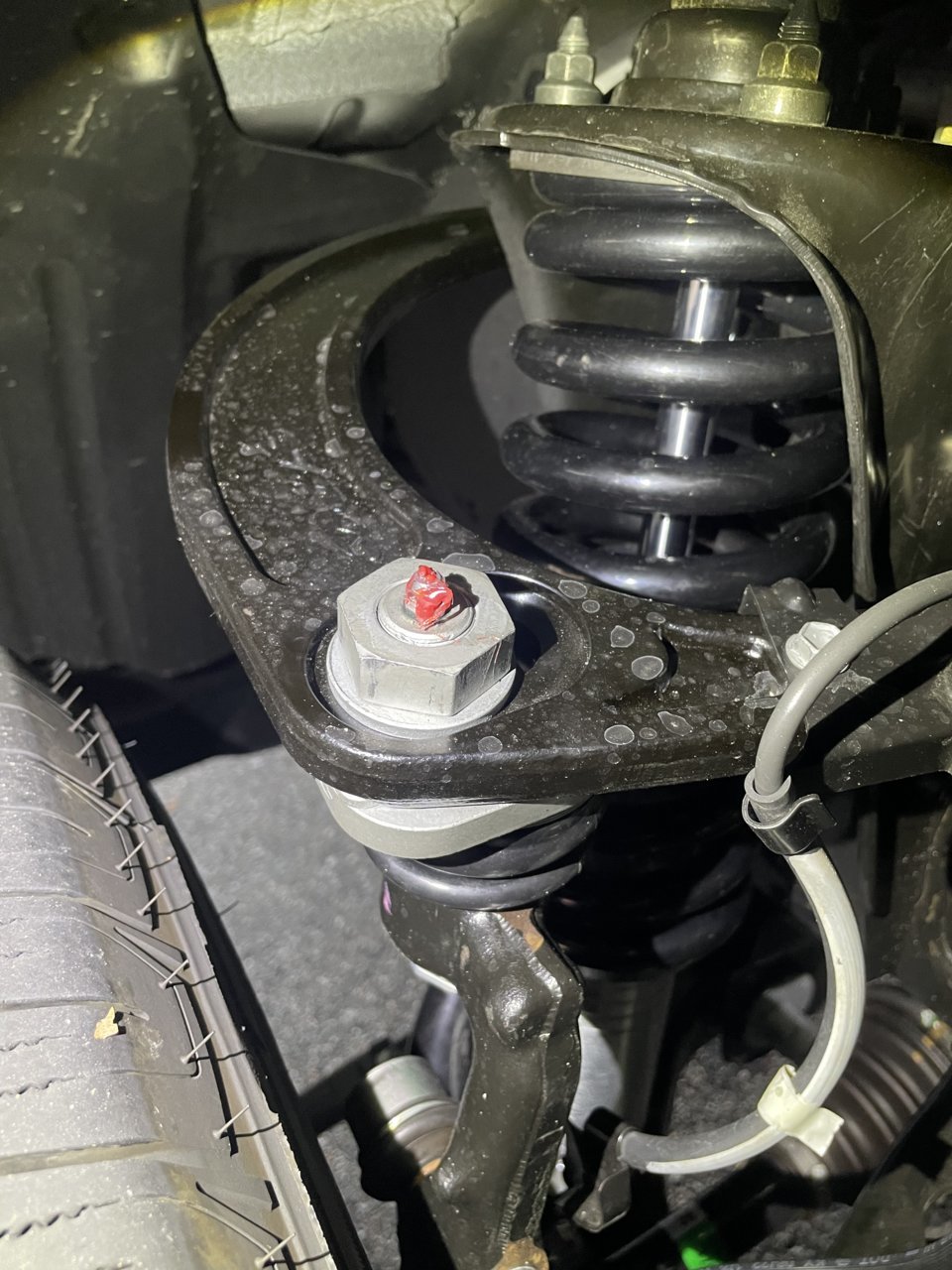

    I don’t disagree, I’m going to call in the morning and see if I can work out a refund or if they have someone that knows better. When I talked to the guy Sunday afternoon, he seemed confident he had a guy who knew what they were doing on trucks with adjustable UCA’s, as well as a guy who was clueless but could “perform” an alignment. Maybe I ended up with the clueless one, but I scheduled my time earlier to get in with the better one. I’ll find out. On another note, see the pictures. The one adjusted more inward is the one with issues. Also, caster adjustment is set at “D” I believe (0* caster).

    Now that I’m looking, looks like I could run into a clearance issue with the new tires going on if I leave it set inward.

    You probably got the clueless/lazy tech. They didn't touch the camber or caster, all he did was adjust toe via tie rods which is why you ran out. That's lazy BS and you could have done that yourself at home with a tape measure. Go back and get the smart tech to do it.
    Lots of shops do it the "lazy" way because the LCA adjusters are known to rust frozen. Without being able to adjust LCAs at the same time as you are tweaking those SPCs it isn't gonna be happy. I know because I had frozen LCAs when I installed my SPCs. After fixing my LCA issue everything was happy.
    So to solve your issue: First need to see if the LCA adjusters move. Mark the positions with a paint pen, take them apart one-by-one, and put anti-seize (I prefer copper/high temp) inside the inner sleeve because that's where they rust and freeze. Put it back together but don't fully torque, then adjust your LCAs to move them forward but keep in mind this changes caster too. Do not fully torque your LCA bolts until it's on the ground and not jacked up in the air!! Adjust your SPC caster settings until you get 3-4 degrees on final alignment. Finish it off by setting toe - factory is like 0.01 each side; I prefer a little more, like 0.03-0.05 each just like your final alignment sheet says.
