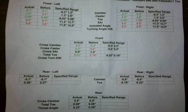

    Go my alingment done doesnt feel right.
    I have LR UCAS
    6-7" lift Icon coilovers
    pro comp 6" drop brackett lift
    33 duratracs
    Heres the problen they still rub barley when turnig sharp left or right on the body mount. when driving it pulls to the right having to correct on steeringwheel to drive straight. Was told this was due to road crown.
    My question is what should i tweek things to to fix above issues. Help me TacomaWorld your my only hope......

    I wish I could get my #'s to look like yours. Mine are way horrid. If your BS isnt correct, it cuold be the reason why you rub on the Cab Mount. I know even with perfect alignment, I will still need to chop mine with my 5bs rim. I cant begin to chime in on what having your size lift does though. I only have a 2.4" lift on mine.

    Put your caster up to 3.1*

    thanks chris how do i fix the pull to the right (road crown) or do i live with it cause my tires are big a grab the road more.

    Add more Caster to correct for the pulling.

    I was told that the caster should be around .5 or so higher on the right to compensate for the pulling to the right (because of crowned roads)....is this true?

    Im confused caster at 3.1 will fix both the rubbing isssue and the pull to the right (Road Crown) is this correct?

    It will help.
