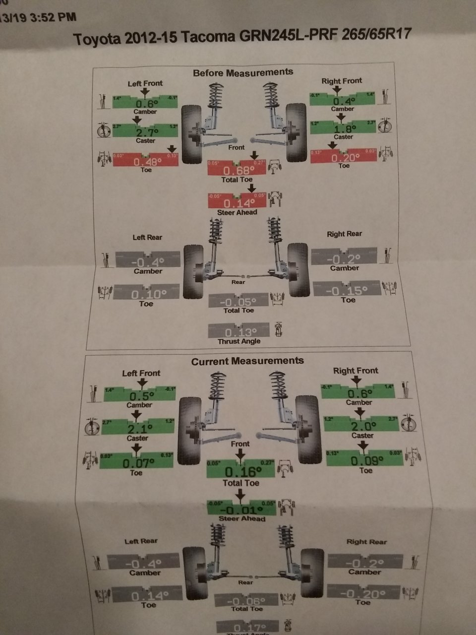

    New Ltx At2s ,3 alignments and LCAs replaced ands pulling to the right. This is driving me nuts what's missing?

    Your rear thrust angle is off side to side...did you have new leaf springs put on before the pull happened? If they weren't centered on the axle or the ubolts were tightened down at an awkward angle it can skew the rear axle to one side and create a bad pull
    That's my unprofessional opinion anyway. Would make sense because your front numbers look fine

    Nope nothing changed, I had new tires put on took it Toyota for initial alignment they had it for a half day and it came back with a horrible right side pull.

    Hm well that's a mystery then... alignment shops don't usually touch the rear of a truck. But your rear numbers certainly coincide with the pull you describe, at least to me. I would have Toyota try and make it right since it happened after they messed with it. Be sure to point out those rear numbers.

    This is how I received it back from Toyota initially

    That's acceptable

    Ok I wondered that was the first try the most recent alignment was in OP which was done after Lca replacement. If the tire swap doesn't work idk what's left honestly. I'll follow up and let you guys know.

    Those alignment numbers look good so all i can think of is either tires or something got left loose. But its probably tires

    My truck has had a pull to the right forever. I finally looked at the rear thrust angle and found it off similar to yours where it made sense to be pulling to the right. I swapped the springs left to right and the numbers looked better but still pulled. I found a "tech tip" that said if it pulls right to increase left front camber and decrease right front camber until the pull goes away, not to go more than 1* cross camber. I adjusted the camber to 0.3* cross as well as increased lf caster and decreased rf caster to 0.3* cross. My truck drives amazing now. Perfectly straight. If the road crown is severe it will pull right but that's expected.
