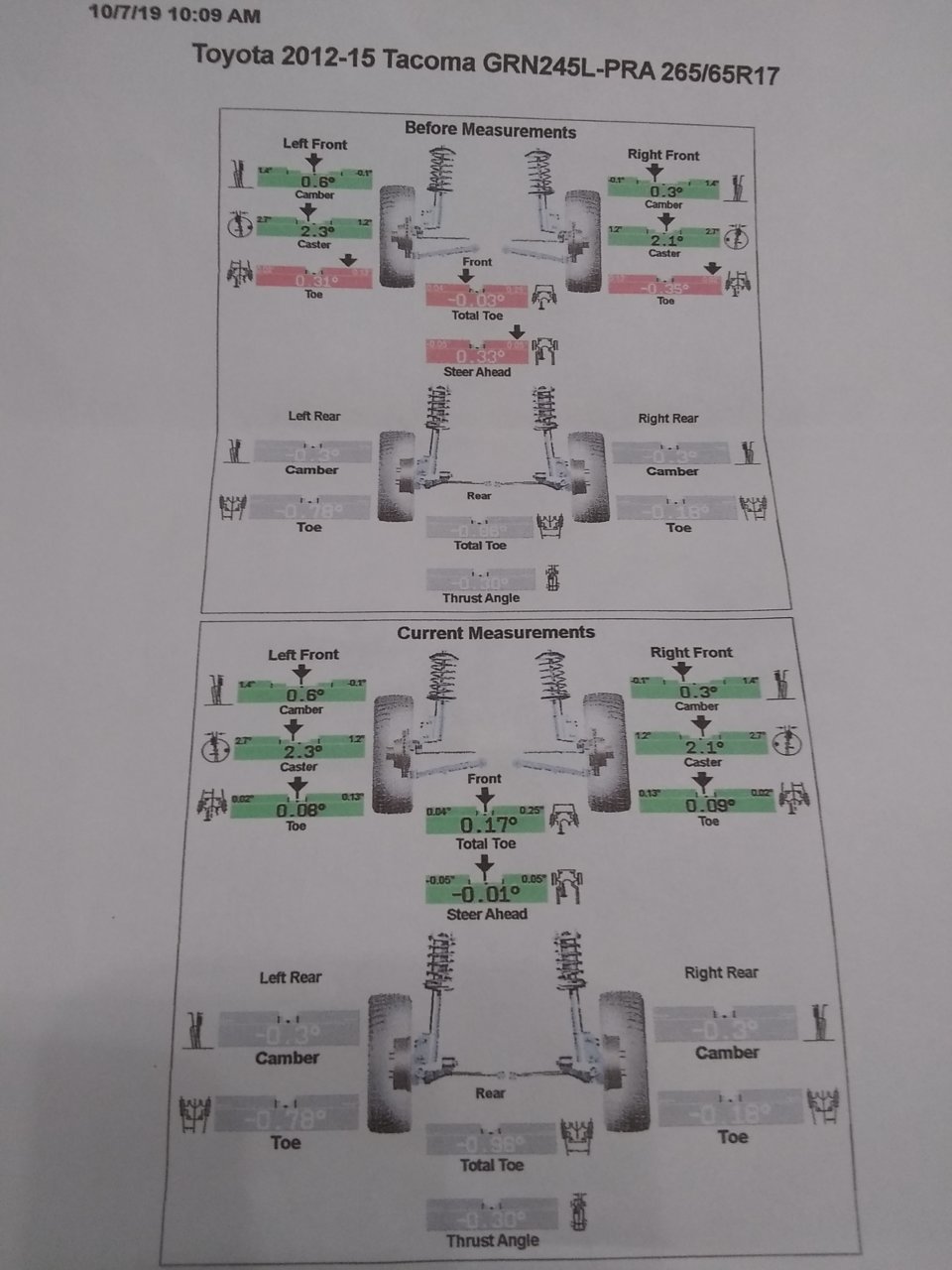

    Brand new tires with less than 100 miles on them, as far as thrust angle I can't figure how it'd be off as nothing's ever been messed with, never went wheeling, hit anything etc. Pretty much went down hill after getting new tires and having Toyota "align" it.

    So ideally where does the thrust angle need to be?

    IIRC, mine was set at 0.12. I can't think of anything else that might help you out. I still am leaning towards those LCA install. I dont have the link to the install data with me but if my memory serves me correct, the cam bolts are to be torqued to 100 ft lbs. Please verify before going with this number.

    A rear toe of -.78* and -.18?? Wow. That is super unacceptable! That give you a thrust angle of -.30, of course it is going to heavily pull! The front looks okay, however. Your alignment needs correction in the rear first. If that's done and you are still pulling it is tire radial pull.

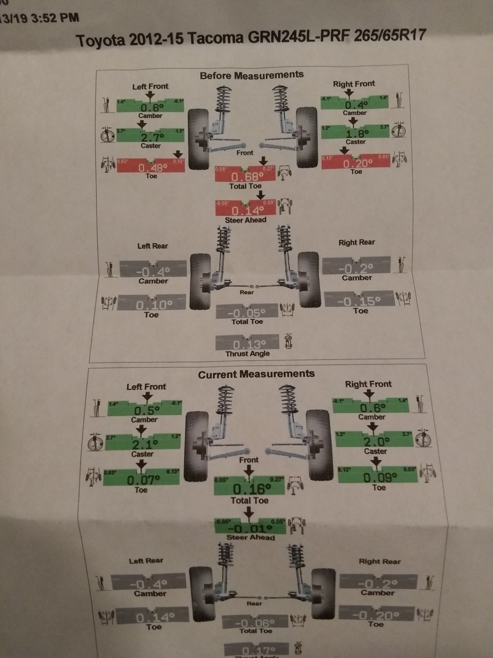

    Well that was the original "alignment" this is where it currently stands.

    As far as the rear thrust angle they probably would not have done anything to shift the axle during the dealer alignment to affect it, and the front toe was corrected to compensate for the thrust so the steering wheel would be centered (that is the "Steer Ahead" value shown for the front wheels on the alignment sheet and it is ok). Besides, the rear values look good so forget about the thrust angle for the time being.
    In the first few responses there were a couple of recommendations to swap tires. Was that done? I can tell you that one of the worst experiences I have ever had with radial tire pulling was with new Michelins. Do not assume that because they are expensive Michelins they are therefore free from that problem.
    As far as the alignment sheet, the before values shown on the alignment sheet suggest the truck could/should have been pulling to the right just a bit. But you did not mention anything in particular.

    So going to pick up today from the shop they road force balanced and matched. They said there was 87 pounds of force to the right and the beads were also not properly set. Going to pick it up but they're saying the pull is single digits now 5-6lbs.
