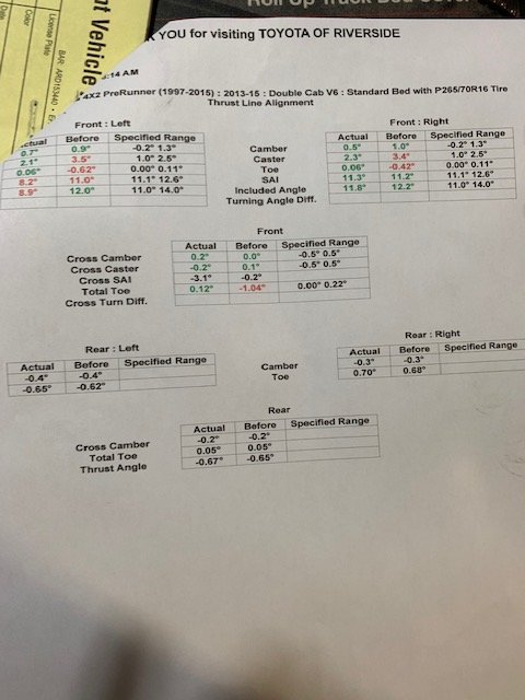

    Installed some new SPC Upper Control Arms with 6112/5160's setup on the forth notch.
    I had it aligned and am wondering if it could be better.... do these numbers look accurate?

    Personally I like more caster. But that’s me.

    very similar to my numbers with same suspension, but without the UCAs. which OME springs did you use in the rear? did you use a space on the front driver side for the taco lean?

    That took away your caster that the UCA’s added. You have to tell them you want 3 to 4 degree caster or they usually won’t do it.

    stupid question, but what is the purpose of so much caster, given the spec is 1.0-2.5 degrees? Is it just to get the wheel to self-center more forcefully? is there a value to that when off road?

    thanks for that. so only reason i could come up with that guys on TW want above spec caster is additional stability for lifted trucks or with bigger tires?

    I did the same with a street driven autox vehicle. Max caster that is the same on each side was the start, then bring in camber, then toe. All as equal as possible side to side.
    Most shops will only do that kind of work at extra cost, if at all, if they have a tech who can, and if they have their machine calibrated regularly.

    Your caster wouldn't be at 2 deg with stock UCAs; they would be closer to 0 deg.

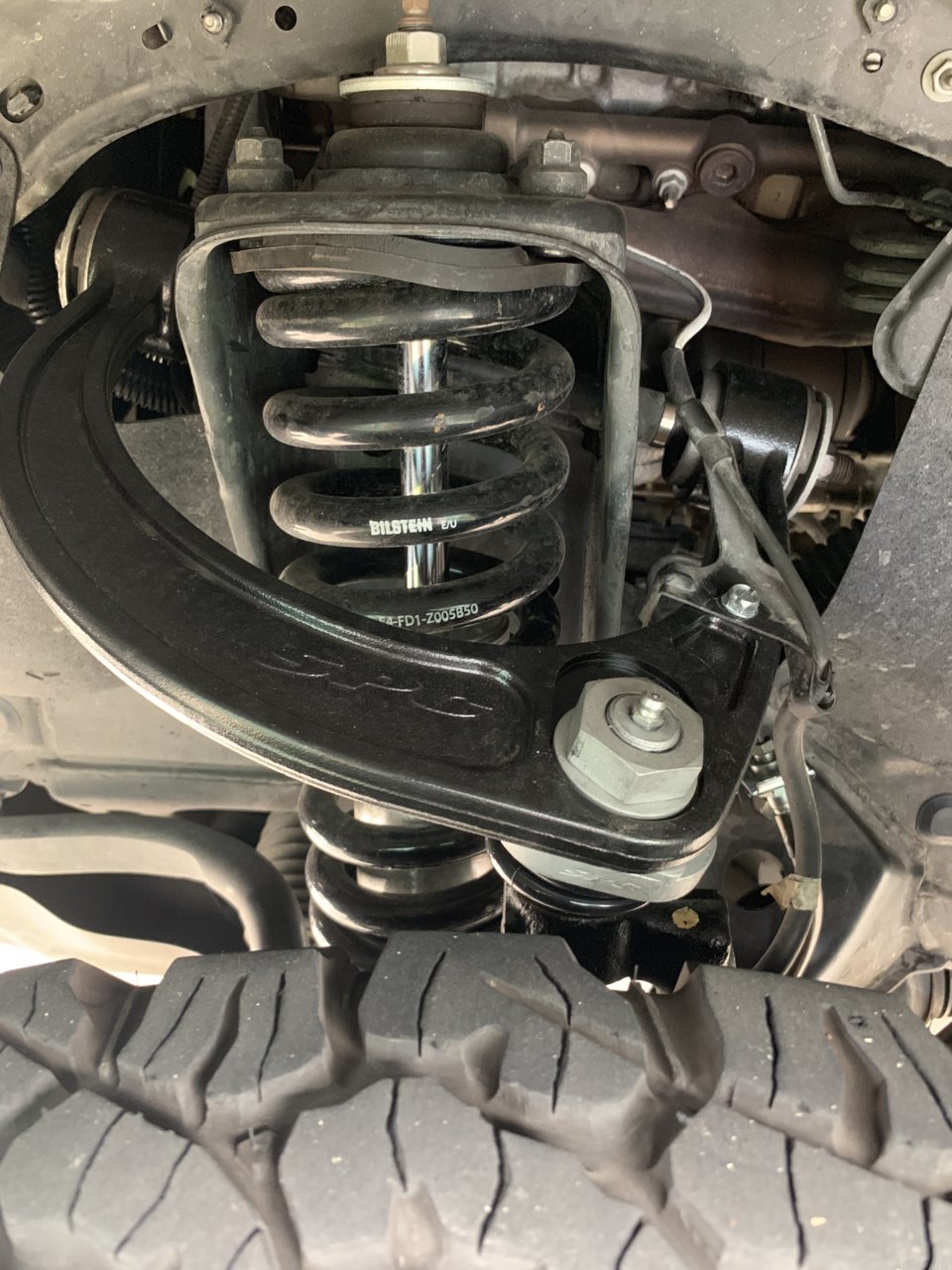

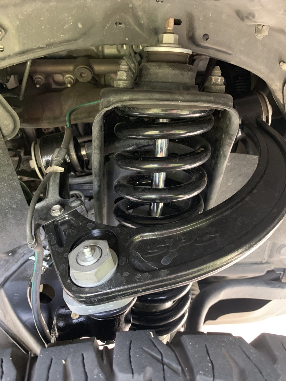

  18. Sep 16, 2019 at 3:20 PM
    #18
    rag9836
    rag9836 [OP] Well-Known Member
    Dec 26, 2010
    #48251
    132
    Robert
    Riverside, CA
    14 Pre Runner SR5 TRD
    Bilstein 6112 & 5160's, SPC UCAs, TRD Pro grill, Cali Raised ditch lights, Pro Runner Cab Roof Rack, Demello Stealth Rock Sliders, SS brakes lines, Power Stop brake kit
    Here's what the setup looks like. Driver side and passenger.
    Driver 2.75" lift with .5" spacer.
    Passenger 3.5" lift
    Everything sits level. Both driver and passenger measure 38" from ground to top of fender.

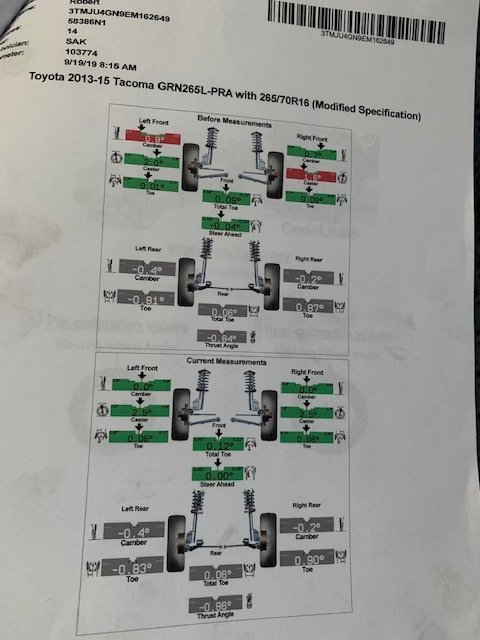

  19. Sep 19, 2019 at 11:38 AM
    #19
    rag9836
    Dec 26, 2010
    #48251
    132
    Robert
    Riverside, CA
    New alignment numbers from a local shop in Riverside, Dave's wheel alignment. These guys know what they are doing.
    He pointed out that my rear was off due to the 2" blocks... I guess there is slight play in them and when installing you need to find a common point on the rear axle on both sides and make sure it's the same distance from the front.
    Rides smooth.
