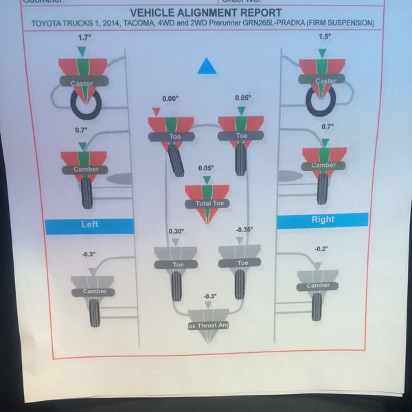

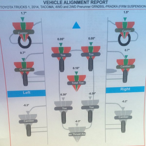

    image.jpg image.jpg These are my results with 6112's at the first setting. Stock UCA. There two pages and it's before and after. Keep in mind that these alignment results are after the lift. The truck drives good and I'm happy with the results. Hope this helps.

    Caster is lower than I'd prefer. You must have got a 2" lift out of those 6112's?

    When it came down off the lift it was rite at two inches but it has settled to 1 1/2 of lift. Thanks for your reply. The trucks about level. Only new shocks in the rear .image.jpg

    Way too little caster & positive camber for the lose! That's how mine looked before UCAs too. Lots of positive camber and nowhere near enough caster. Those two numbers will get further from ideal the higher you lift until you'll eventually be out of spec but even within spec (like the pictures here) the truck will still drive like ass & I hate positive camber. Looks dumb too.

    Thanks , I'll get it back in and have them try to dial it in better.

    That's just my opinion. Don't be surprised if they tell you that that's the best they can do with your hardware. It's likely you are nearly at the end of your adjustment if not already there. Your camber will go positive as they try to dial in caster. Maybe they can do a little bit better but don't be surprised that you will need to add a pair of aftermarket upper control arms to get your alignment where you want it to be.
