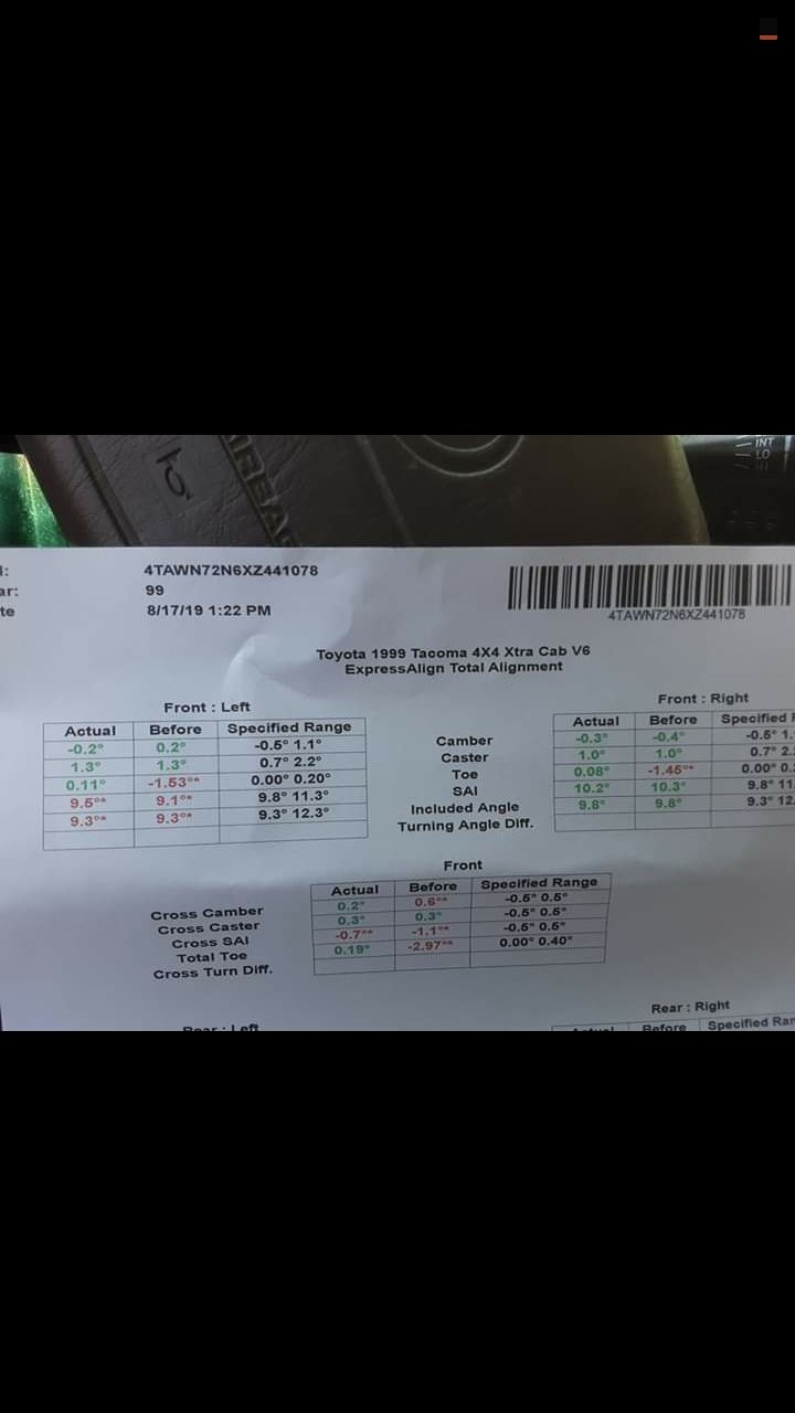

    Just got an alignment after replacing lca bushings, upper ball joints, steering rack bushings and tie rod ends. What would make the left side just slightly out of spec still?

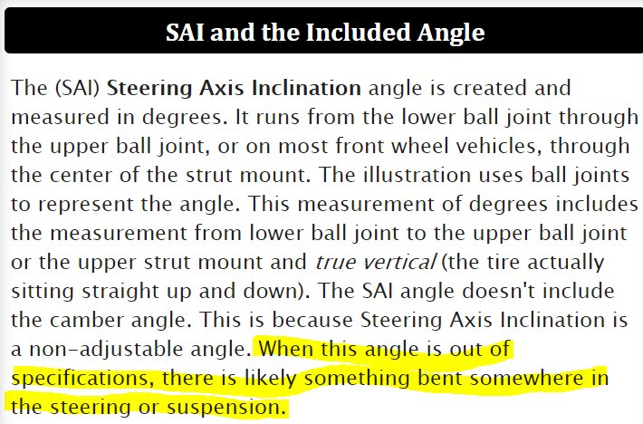

    What was the reason given when they handed the keys and report to you? Did you ask? I'd call the shop up or go back and ask them to explain it to you. Also ask if they inspected your suspension components and verified everything was OK (see highlight below). A good shop should be checking your suspension components as part of the alignment service.

    So the alignment tech just gave you the truck like this and didn't make any suggestions as to why the alignment wasn't able to get within spec?
    Sounds like you need to find a new alignment shop.
    Curious why you went through all the trouble of replacing the upper ball joints, bushings, tie rod ends, but left the lower ball joints?
    The LBJs should be first on your list, and then replace all that other stuff while you're in there...

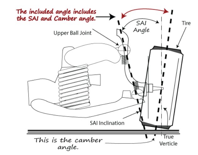

    Something is most likely slightly bent. Sometimes it is very hard to spot a bent component. The number is only out of spec by .3 degrees and is different from the right side by less than 1 degree. They should have explained that after you got the print out of the alignment. It will not harm anything being out by that small of an amount.
