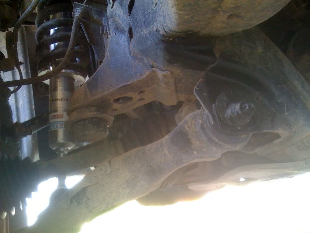

    so this is what it looks like, if you ask me its not too rusty, infact that is mud you see in the pic not rust and, there is undercarriage coat sprayed on the thingys

    What's the position of the other cam bolt? Does it look like it is in the same position or close to it? I don't rust either.

    the other side looks very similar in position, if you ask me it doesnt look like he even got the bolt to move, the coating that is sprayed over it has not been broken along the seem

    alright I took some more pics, to me underneath it looks like it could be adjusted to push the bottom of the tire out from the center of the truck. Im pretty sure what happened was the rear two adjustments on both the left and the right were sprayed with undercarriage coat and he didnt even bother trying to move them. so he just moved the front two to get the caster right.
