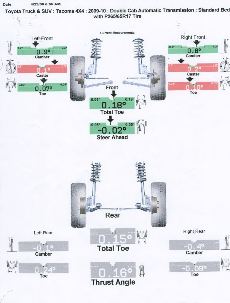

    I just got a 3" OME lift installed. I did not get aftermarket UCA's and the shop said it aligned just fine. Do these numbers check out? Thanks

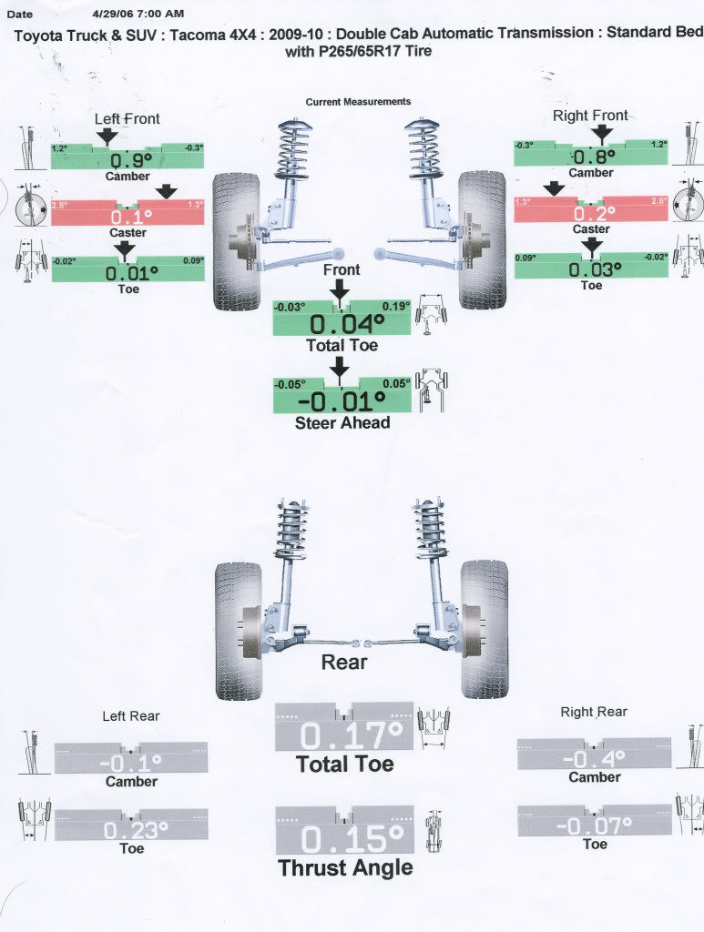

    Before and After Alignment numbers

    They look acceptable. Caster isn't as important as camber & toe. As camber & toe being way off will wear your tires out and your truck will not track straight.

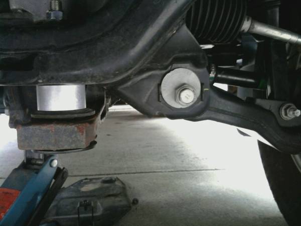

    Also , have you looked to see if your alignment shop flattened your aligmnent tabs to get you extra caster ?

    No I didn't check, don't know where the alignment tabs are? Hmm I'll have to pay attention to the wander when I drive on the highway to see how bad it is. Besides the wander the tires should wear evenly with these specs correct? So if I can live with the wander - no after aftermarket UCA's needed? I just don't want to spend the $500 or so unless I really need to. Thanks for the help!

    The alignment tabs are where the LCA attaches to the frame

    Thanks for the info/pics - I remember him saying the caster couldn't be adjusted so I don't think they did anything but I'll check. Well I've already spent my a$$ on lift/tires/wheels why stop now - LR UCA's it is :)

    Looks like all they did was set the toe. Camber could be better, and the caster is way too low.
