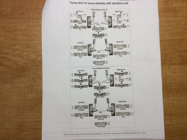

    I just installed 5100 with 884 springs and 5100 on the rear with my existing Firestone air bags on my 2013 TRD Sport 4x4 double cab with stock tires. I had the alignment done today with these results. Do these numbers look normal? image.jpg My concern is I have a slight road noise. The best way to describe it is like a hum from a tire. Not sure if it is tire noise or driveline noise.
    Thanks for all your help in advance.

    Caster looks a bit low to me. Did you ask for specific numbers? I would think that with your lift you'd want at least 2 - 2.5 degrees of positive caster. Does it wander or is it twitchy at all?
    Mine developed the front diff groan immediately after lifting. Gonna get the new Toyota bearing since I'm still under warranty. Search it here - there's 175+ pages of detail on it. Not sure that your alignment numbers would cause road noise. Can you tell at all where the noise is coming from? Front? Rear?

    No I didn't ask for specific numbers. Sounds and feels like its in the front. For the little I drove it seems drive OK.
    I'll have to drive it on the highway and see how it handles.

    If you're OK with how it drives you'd probably be OK with leaving it but if you take it back I'd ask for 2.5 caster, 0 camber, 0 toe. Problem is with stock UCA's (assuming yours are stock) if you go too high on caster you'll have a negative effect on camber which will wear out your tires on the outer shoulders. I told my guy to get the caster as high as he could without positive camber - I got 2.5 (give or take a few tenths left/right) with only .5 positive camber and it drives good. I'll be adding adjustable UCA's as soon as I can build up my mod fund again.......

    Only issue I see is the camber. That should be zero, but may cost you some caster to get there.
    The half degree camber will change the wear pattern on your tires, probably what you are hearing.

    Really? Half degree would create noise and uneven wear? I'm surprised by that - don't want to give OP wrong information, just speaking from my personal experience.

    How many miles do the tires have on them and was the truck in line before the lift? It's amazing how fast tires wear in to the specs. Then, when you change them, they need to wear in again. If it's minor, I'd leave it and let everything adjust. I'm guessing that unless you have new tires already, that new tires would solve that problem.

    They are stock tires with 31,000 miles. Not sure how the alignment was before the lift, but tires were wearing even.

    That's an OK alignment.
    Folks with lifted Tacomas typically trade off some camber to get more caster. Your camber is fine for tire wear as it is. But the truck would drive a little more stable if you got the camber numbers closer to zero so as to increase caster.
    Still, that's not a bad alignment, and if you take it back and ask them to change it according to preferences you didn't tell them the first time around, expect them to charge you to do it again.

    Yeah, it's amazing how subtle the "set" on tires can be. Still snce it was wearing evenly before, just tough it out for a few 1000 miles and it will probably adjust to the new alignment. The new alignment looks to be within specs so it's not alignment, IMHO. If the tire whine bothers you, it will be a good excuse to ditch the stock rubber nd put on something more interesting!

    Half a degree will create some noise, especially on the ride home. If that's the cause it should be gone in a few days.
    ETA: that half degree, for his truck and his tires, might also just be a resonant spot that makes noise...
