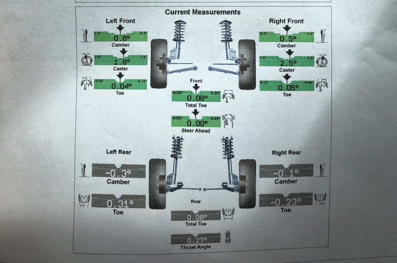

    Below are my alignment specs. I know the go to is 3* of caster and zero’d out for camber and toe when it comes to an alignment, but wanted to see if there are any things I should be concerned about.
    I feel like I have to fight the wheel in turns and it’s kind of jerky. That may not be alignment related but instead our awful TN roads. When looking at the front of the truck it looks like my front tires are like this “\ /“ but not so drastic obviously. A lot of the trucks I see on here have a nice even stance up front like so “l l”. This may purely be an aesthetic thing, but I really am outside my lane when discussing alignment specs. Any help would be greatly appreciated.
    The photo below are my current alignment specs.

    Also I did get an alignment and the alignment specs were posted in my original post.
    Edit: photo wasn’t showing at first, but should be fixed now.

    What's your camber at right now? You don't mention it in the first post.

    According the the alignment specs photo in my original post .6* left front and .5* right front if I’m reading it correctly.
    Edit: apparently my photo wasn’t showing up originally. It should be showing up now.

    you want 3 caster 0 toe and 0 degrees camber

    Should I go with a slight positive toe to avoid excessive tire wear or is the 3/0/0 pretty much the gospel?

    You could do a bit of toe if you want. I always go with 0 though and it works well.
