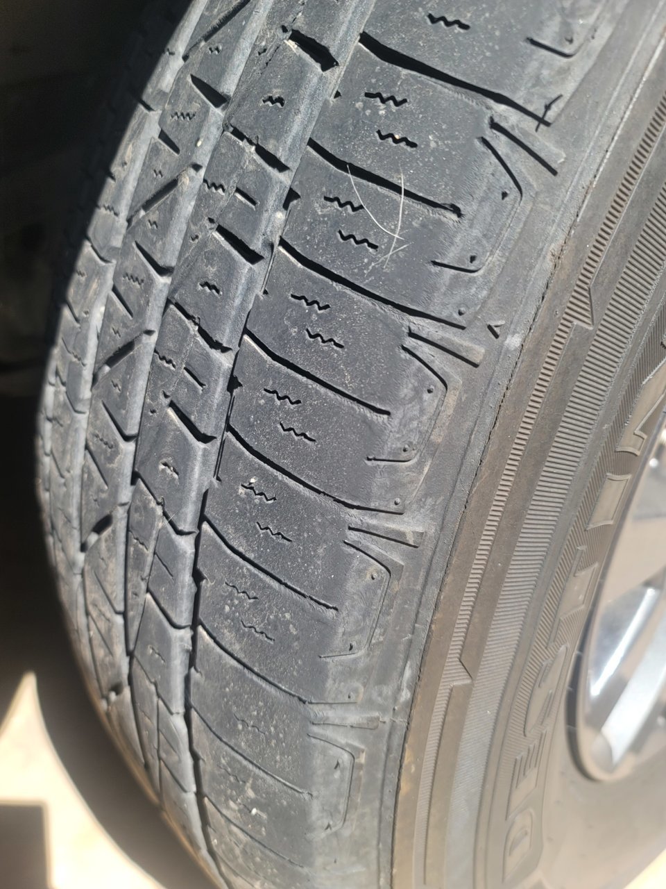

    Is this what your tire looked like?

    Most trucks come with too much positive camber from factory, which if you do a lot of city driving (lots of turning) it'll wear the outside pretty fast as it gets worse when turning.

    Exactly. My dealer said they had to reset the toe.

    When the dealer informed me i needed an alignment for that same reason. I asked the same question if the camber was causing it....they said no, its definitely a toe issue. Well whatever it was it appears corrected.
