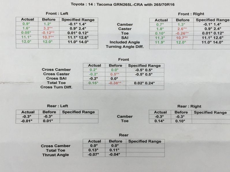

    I lifted my 3rd gen last week. Bilstein 5100s set at 0.85, OME 887 coils, LR UCAs set at 0, deaver AAL in the rear and 285/75/16 BFG KO2s. The next day I got it aligned.
    A couple things cause concern in my noob mind. It does rub plastic on the back portion of the wheel well at full lock in reverse which I expected. Would adding positive caster give me extra clearance? Also visually the camber "looks" to be too much \ /. Here's my alignment sheet, any advice or insight would be greatly appreciated.

    Your camber should be closer to 0 and your ride would be better with more caster, like 2.5 or more. How much height did you gain with that setup? I think 887's are meant to be installed on the 0 setting. How does it steer on the highway, any wandering?

    The truck rides good, no wandering and tracks straight.
    With the 5100s set at .85 I got 3.25" up front and in the back 1.5". The truck sits pretty level maybe a hair high in front.
