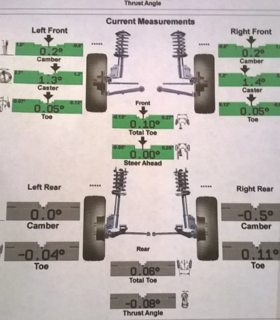

    Ok, so first off, Les Schwab lost a customer today. I took my truck in for an alignment after installing 5100s, 885s and a 3 leaf AAL. After getting wrung up, the technician under his breath said "I can't believe you fucked up such a beautiful truck like that." When I asked him what he said, he told me he couldn't believe I'd put a lift in my truck, and that it completely destroyed my alignment.
    It's a strange comment, because that's why you get an alignment after installing new shocks right? On top of that, the alignment they did left the caster still about a half a degree out of spec on each side. Is this ok? What's the impact to that? Is the guy correct that I somehow fucked my truck up? Even if he's right, that was a horrible way to speak to a customer. I'll never go back to Les Schwab again after that.
    Here are the numbers below:

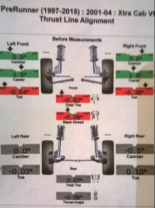

    I dropped mine off at a reputable off-road shop here in Houston and specifically wanted an alignment on my new TC UCAs. They claimed they did it, "and it drove great" I wanted the alignment paper. "Oh...uh...let me check" Shockingly, no paper. I told the manager I wanted the alignment sheet as I am going to post it to Tacoma world in the 1st Gen section and show what a great job these UCAs can do with a good tech. His face changed noticeably after that. ;)
    Amazingly, they took the keys from me, drove it back around. took 20 min and test drove it. Manager stated the moron didn't adjust it as "it looked good" when it came in. He was just lazy and didnt touch it after telling the manager he did. You can see below it didn't and manager was not happy. Nor was I but at least I rec'd a good alignment and I didn't pay for it either, refunded my money for that piece of work.
    Bottomline: I'd take it to another shop before going the UCA route and watch them do it. If you need UCAs, get JBAs or TCs
    Before
    After
