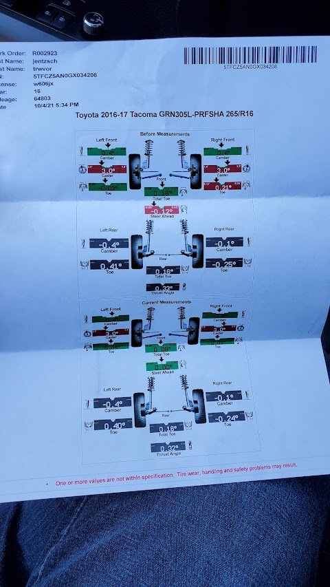

    I had my alignment done the other day at a Les Schwab. It still pulls to the left and the steering wheel was not aligned properly.
    Do these numbers seem right? Why is the caster so "off" or out of spec based on what it says on the paper? Or am I misreading this?

    2 things
    1. How bad does it pull, I ask because with the crown of the road it might pull one way or another depending on what road your on.
    2. I wouldn’t worry about caster as it’s identical side to side and isn’t a large factor in how the tire will wear.

    The thing that really bothers me is the steering wheel not being aligned properly. It stays turned to the left. When I try and center it, the truck turns right pretty aggressively.

    Looks like they just did a "toe-n-go".
    Your before toe was compensating for rear thrust. Now that it's even, there's a pull.

    So basically, they rushed the job?

    Technically, you got a standard 2-wheel front end alignment with 'excessive' caster(unless you requested otherwise).
    You need a thrust alignment with before and after test drives.

    I don't know why they even bothered measuring the rear if they weren't going to do a thrust alignment.
    Pulls left, so steering wheel is cocked to right, correct?
    My guess is you'll end up back at your before measurements.

    Why they even bothered putting the reflectors on the rear was my point.
    They either had intentions to do a thrust, then said, "fuck it". Or, they never had intentions, but went ahead and mounted the reflectors; might have just been habit to mount all 4. Either way...

    I know on our machine it wouldn’t let you do an alignment without all 4 on. Of the 100 some alignments I’ve done and helped we’ve only touched the rear end like 6-7 times but we had to put the rear reflectors on every time just to get the machine to work.
