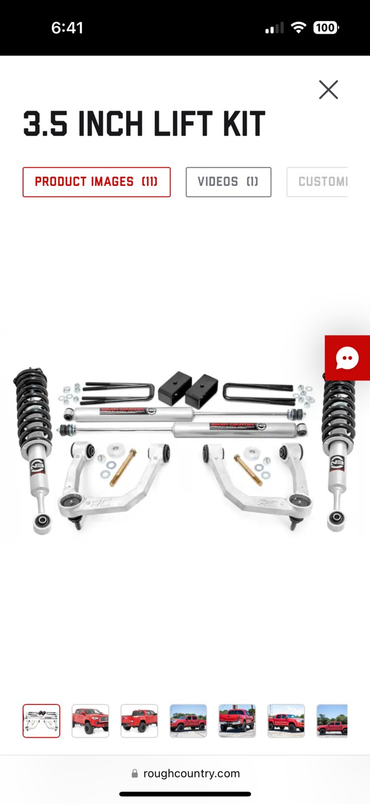

    I have new UCA that came with the 3.5 rough county lift
