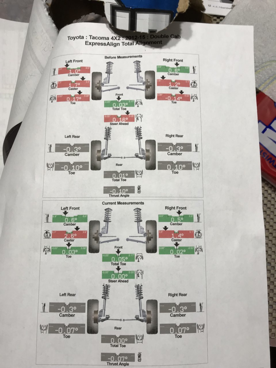

    Hey guys got my bilstein 5100 on and got an alignment
    specs look ok? Or… where’s the alignment mechanics! Haha

    Lol can’t find much info, installed bilsteins snd here’s what I got not sure if good or bad alignment guys never said

    That right side seems a bit “odd”.
    Not much changed except the toe.
    Did they say anything about the cam bolts in the control arms?
    I don’t know what size lift or tires you are running.
    But it think most like 2.2-2.4 caster?

    They never said anything man, just paid and left didn’t look at the sheet until afterwards, tires are stock 265/65-17 bilstein 5100 on first clip above stock height, everything good

    Do you have any pulling or are you ok with how it drives?

    Really surprised there's no complaint of pulling.

    Caster needs to be redone.
