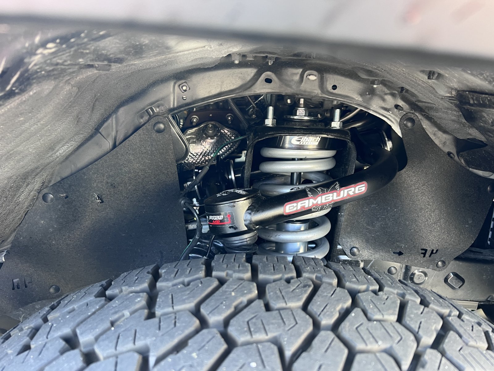

    I’ve searched and can’t find a simple answer. Anyone, someone, please help! I just got an Eibach Pro 2R lift with coilovers, rears, a Deaver add a leaf and camburg UCA’s installed on Method Double Black 17’s with 265/70R 17 Wildpeak AT4’s. Prior to the lift, the wheels were rubbing a bit on the driver side front plastic wheel well. Now, any bump or turn (especially in reverse) and the fronts are hitting the cab mount and rear fender well. Anyone have the correct alignment specs? I was told 285’s would fit without rubbing yet the 265’s are rubbing! Help please! I’ve had two alignments done and still no good. I don’t think my local shop does off road suspension and just goes with factory specs.

    285s will fit with trimming, they will not fit without rubbing. 265s will fit with no trim and no rub with good alignment. You need to be 2.9-3.3 caster, near 0 on camber, close to 0 as possible on toe and steer ahead. We aim for passenger caster to be 0.2 degrees more than drivers for curvature of roads here but that should be fairly spot on.
    What offset are the methods?

    The Methods are 0 offset. Will that be an issue? Thanks man! This is really frustrating for sure. I love my truck and this is the first time I’ve done something so extreme to a vehicle.
