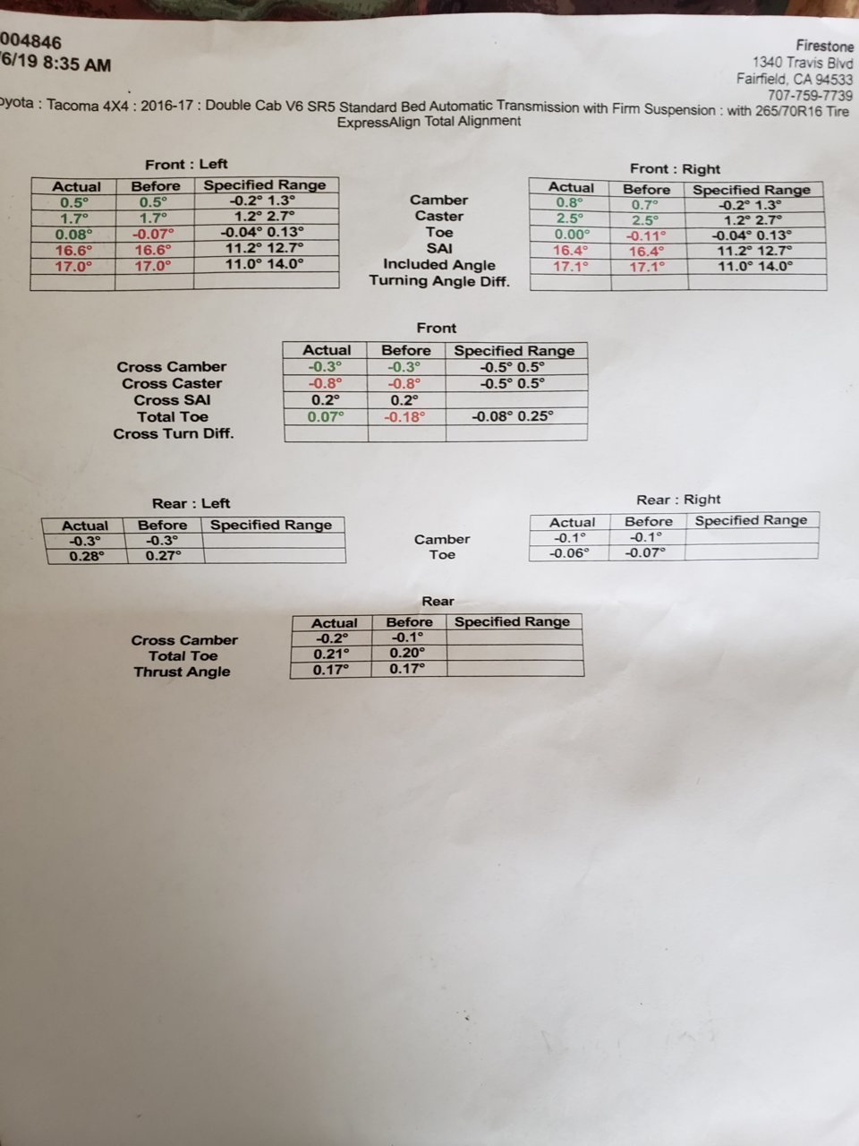

    UPDATE:
    I went and got a new alignment. So far, it drives better and doesn't pull to passenger anymore. However to remediate the rub, I am planning to adjust my lift to make my truck sit a bit higher then I will get another alignment. After the new alignment, I will start trimming.
    Below are the results:

  6. Feb 11, 2019 at 5:01 PM

  7. Feb 11, 2019 at 5:06 PM

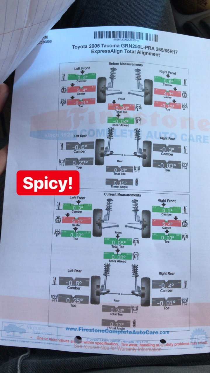

    2017 Tacoma DCLB OR (first time Taco owner)
    TOYTEC 2.5 kit, SPC UCA, N-fab side steps, TRD pro grille, FN FX PRO Wheels, BFG KO2S (265/70/17 C Rated), TRD Skid plate, Tyger Tonnue Cover, OVtune, Borla S type exhaust
    Hope you guys can help me with this. I recently got my Tacoma lifted about 2 inchs front and back (Toytec 2.5 kit with 3 leaf aal and SPC UCA, Have had 265/70/17 C ko2s on it for about 35k miles now, had them on when the truck was stock. ). After my lift, my shop guy did get the alignment done and I do remember the truck tracking fine and the steering wheel not feeling as loose. After about 1k miles on my new suspension I thought it was a good idea to get another alignment done for good measure (from different shop, Firestone, now learned that was a bad idea). However, after this second alignment my truck feels out of wack. When driving it tracks to the left, the steering wheel feels much looser (lots of play and small random movements when driving), and at low speeds when going over some bumps or dips the steering wheel turns hard to whichever direction the bump or dip swings it to. On top of that my Steering wheel is off center to the right by about a degree or two. I have an appointment with my shop guys alignment guy this week to hopefully correct the problem. I've attached the alignment spec sheet that was given to me from my second alignment (the cause of the wacky ride problems). Hopefully someone with some good insight can look at this sheet and give me some numbers to run by the alignment tech this week. Your time is greatly appreciated.

    Cross caster is high. 1.7 on driver side and 2.5 on passenger. It is normal for passenger side to be higher, but only .3-.5 normally. Maybe start there. Raise the caster on the driver side to meet passenger side. See if he can get at least 2.0-2.2 and start there
    Edit: Looks like a toe and go after looking at the sheet again. Lazy tech

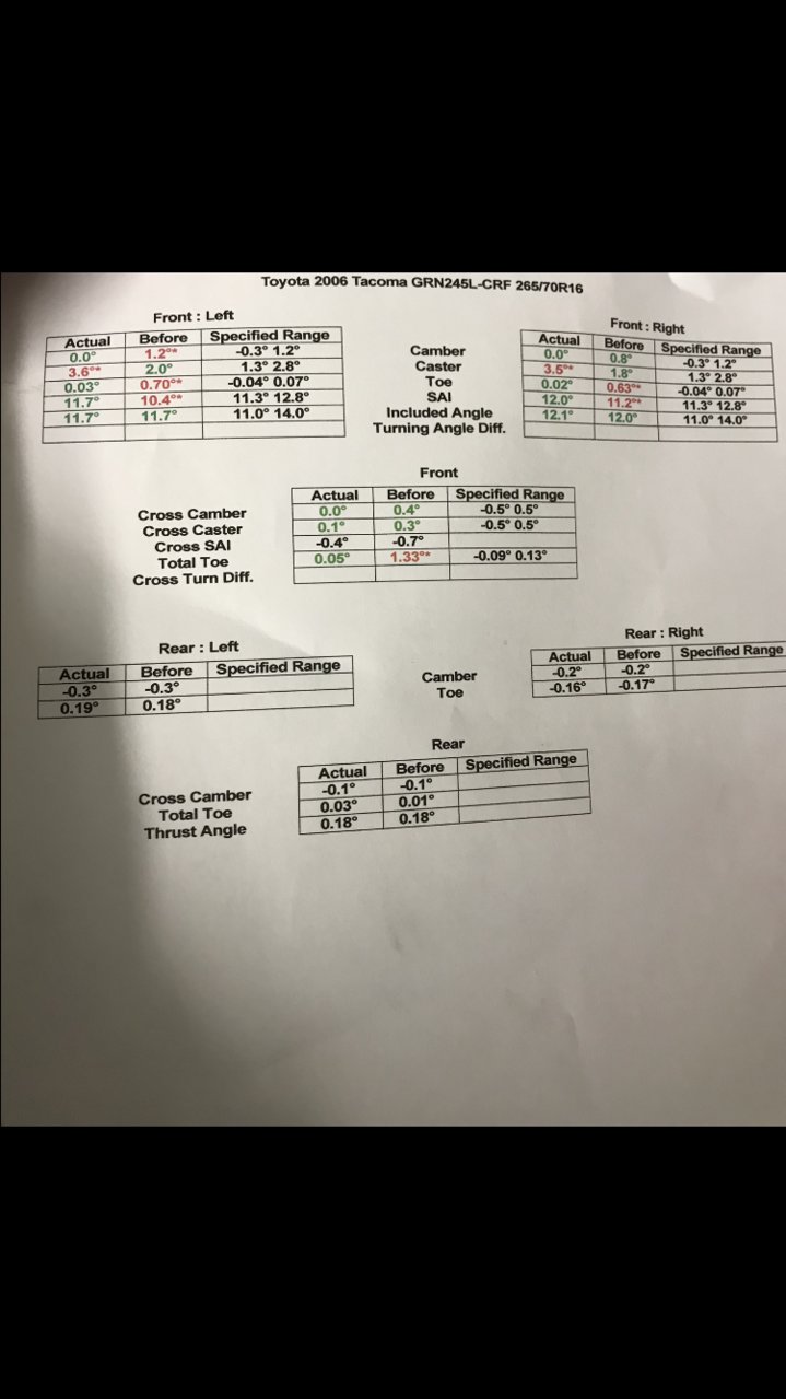

    Was hoping to resurrect this thread. I am having darting/wandering issues and is difficult to maintain straight. Dobinsons maybe half inch lift in front 1.5" in the back with aal. 255/70/18. Getting an alignment done tomorrow with higher caster. Grateful for any suggestions
