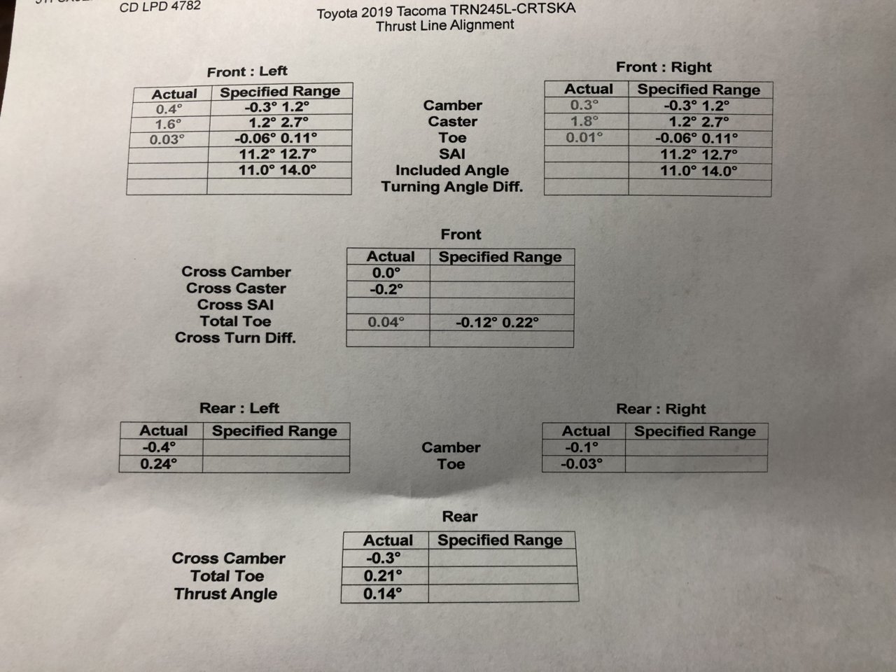

    Resurrecting an older thread. Just added 5100/887 and 255/85/16 Falken MT’s. Had alignment done with tire mount. These are my numbers. I am still on factory UCA’s. From what I read here, I am understanding that I prob want more caster though I have to admit, I’m a fairly smart guy but I don’t understand this very well. Anyway, on my stock UCA’s would they be able to adjust the caster any more? Thanks for the wealth of knowledge!

    I literally know nothing about how to read this. I asked to have my wheels moved forward as much as they could to help alleviate rub, I do have the cmc done as well as spc ucas. Screenshot_20210219-001414_Gallery.jpg

    He maxed your caster at the expense of your camber. You may wear the inside of your tires prematurely. Should have been able to get that camber in spec with the separate adjustment on the SPC UCAs. I would have reversed those side to side caster readings to compensate for road crown. Do you have a rear lift? Your rear axle may have shifted slightly
