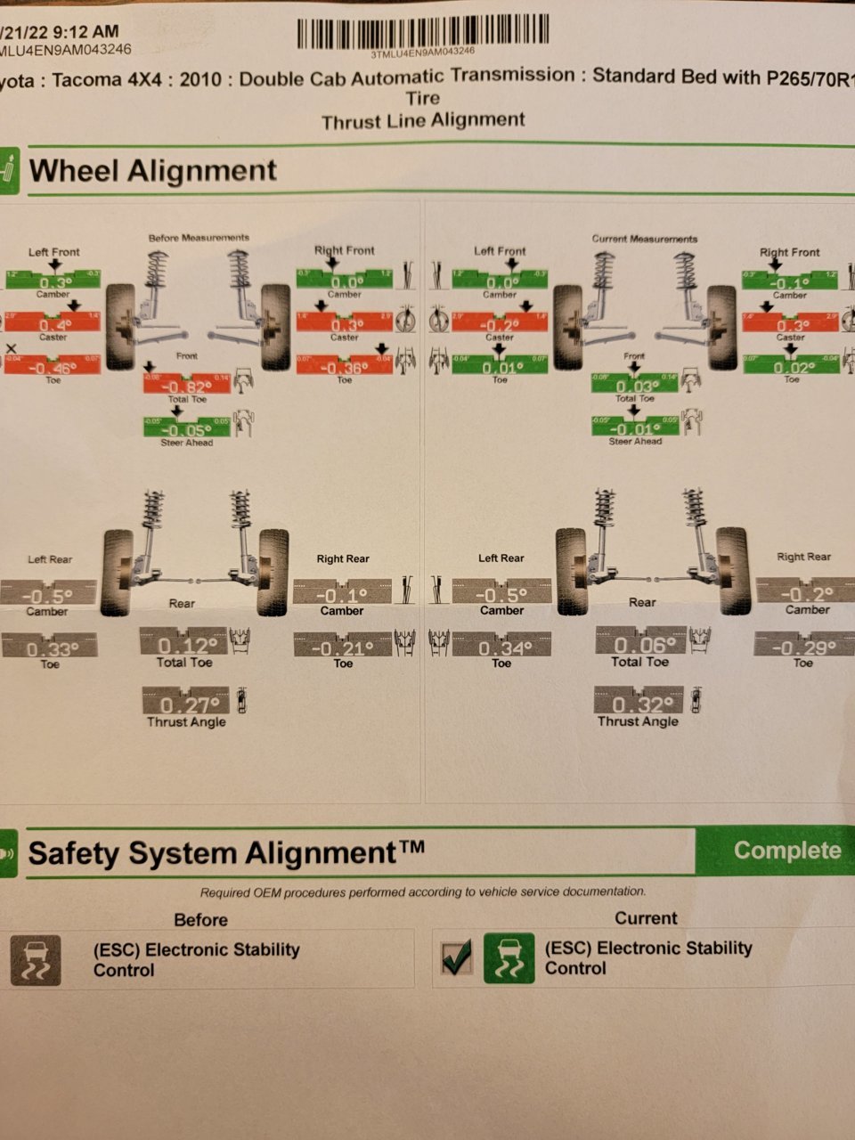

    Gonna revive this real quick.. just got an alignment done at a local shop. Tech knows his stuff, has SPCs on his personal Toyota.
    Camber and Toe turned out perfect, but caster numbers are maxed out on the cams without serious effect on the camber.
    Setup:
    6112s, 700 pound springs, 6th notch, spacers for tacoma lean.
    Camburg UCAs.
    Rear new packs and add a leaf, 1.5 inch block.
    255/85/R17s. Sits something like 5 inches higher than stock.
    The caster is L -0.2, R 0.3. It drives better than before the alignment, Rubbing it no issue, should I leave it alone or start looking for SPCs to adjust more caster in? Thanks a million for all the info in here, read just about all of it before I took it in. Was hoping to see like 3.5 degrees of caster.

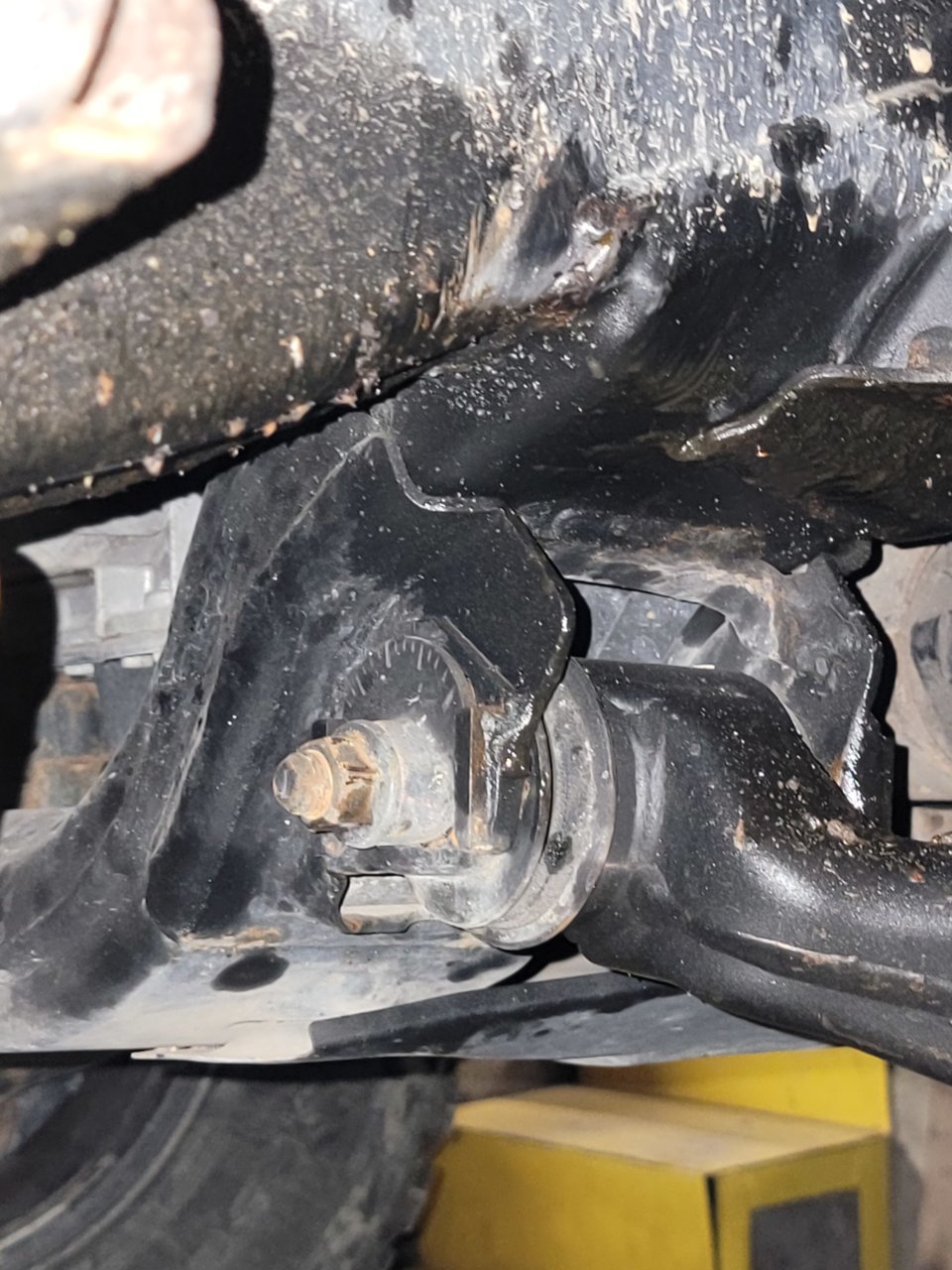

    Can you take a picture of the lca cams on both sides? Are you having any issues with it pulling right or wondering on the road? If not you may in the future If you ever decide to run a wider tire.

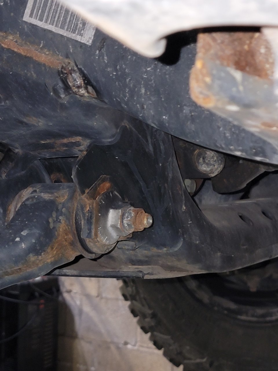

    Bilstein Lift, Bronze Artillery Wheels, Baja Designs Lighting,
    @modifiedtaco Here's driver then passenger. I'm working to understand how exactly these are adjusted, but I don't just yet. Looks like the cam should be facing towards the inside to push the LCA forward and produce more caster, which these aren't.
    It tracks straight, and seems to be compensated for road crown with the caster split.
    I'm going to drive my dads third gen when I get home, his caster is right at 3° so I want to see the stability difference and decide if there is need to keep fooling with this.

    Tuff Country 3 inch spacer kit with aal Tuff Counrty 1/4" spacer on LF (for taco lean) Bilstein 5160 rear shocks Bilstein 5100 adj front struts (removed tuff country front spacers) set to 0 lift OME 886 coil springs Front sway bar relocation bracket N-Fab Rock Rails 17x9 -12 Fuel Beast wheels Toyo AT2 285/70/17 tires Led light conversion on all interior lights Morimoto 35w HID kit 5500k OE all weather floor mats OE Tonneau cover OE Door Sill Protectors Bed Mat De badged all factory emblems matte black vinyl tailgate letter and Tacoma emblem on door silver vinyl insert on glove box and door sill protectors OME Carrier Bearing Drop Insain Fab cab mount chop plates Weathtech Rain guards
    The lca's have two cams each. If I was aligning it I would start by maxing the passenger rearward cam for positive caster by turning it inward then seeing if using the passenger forward cam can bring camber pack up within specs. Lastly I would adjust the driver side camber to match while attempting to leave a caster split to help compensate for road crown. If the correct caster split is not achieved then I'd return to the passenger side to tweak it a bit to achieve the best alignment possible.

    I'm going to question the techs knowledge. Either that or I am going to question his work ethic. As shown in your pics, he didn't bother to touch the adjusters. You got a toe set which you badly needed, but your caster is terrifying. What I find odd is that you claim to have Camburg UCAs, but your caster is still bad. The UCAs should have built in caster. That is the whole point of getting UCAs. Honestly not familiar with Camburg's product line, but seems odd that they would sell UCAs with stock geometry. Swapping to SPCs only gets you upper adjustability which if the Camburgs didn't get you caster, they won't make any difference.
    @modifiedtaco gets it. The challenge you run into adjusting caster is that camber is going to change as well. I would worry less about camber being out than having close to zero caster. You need caster. At zero it won't track straight and you are constantly correcting. Dangerous situation unless you can somehow constantly focus on the road and never have to take a hand off the wheel. Change a radio station, look in your review mirror, grab a drink, sneeze, etc. Anything like that happens and you can be in the ditch before you know it.
    You should be able to get close to a degree and a half with some adjustment. Keep in mind as modifiedtaco stated that when you adjust caster, you run the risk of rubbing because it changes the position of the tire in the wheel well as well as the sweep when turning. It is a delicate dance, but you are better off hacking some plastic and running zero caster.
