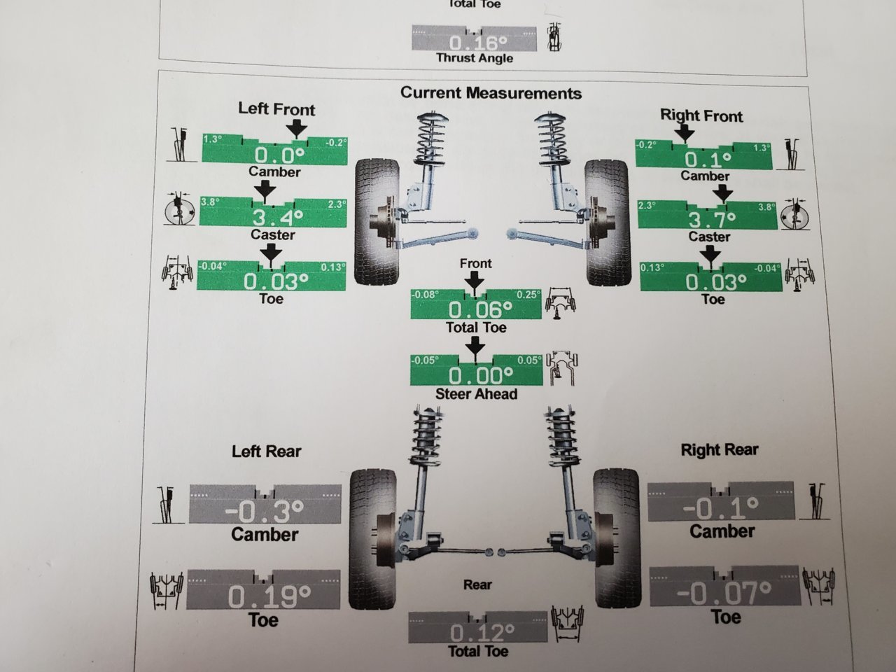

    Just installed my Dobinsons MMR’s w/ 314 coils on my 2021 Tacoma TRD OR. Set things up for a mild 2” of lift in the front. Running 285/75/16s and factory UCAs. Going to get a front end alignment today, what do I need to tell the alignment shop regarding caster/camber/toe settings to minimize contact with cab mount while maintaining good road manners and tire wear? I have read so many posts and they don’t seem that clear to me on what I should tell the shop.
    Thanks in advance for any feedback.

    Here is the print out from Toytec after they installed my lift. I have 285/75/16 on OEM wheels, 1.25" spacers, and SPC uca's. I've been through some big enough rock piles that it would have rubbed if it were going to...NO RUBBING anywhere and the truck drives great. :cheers:
