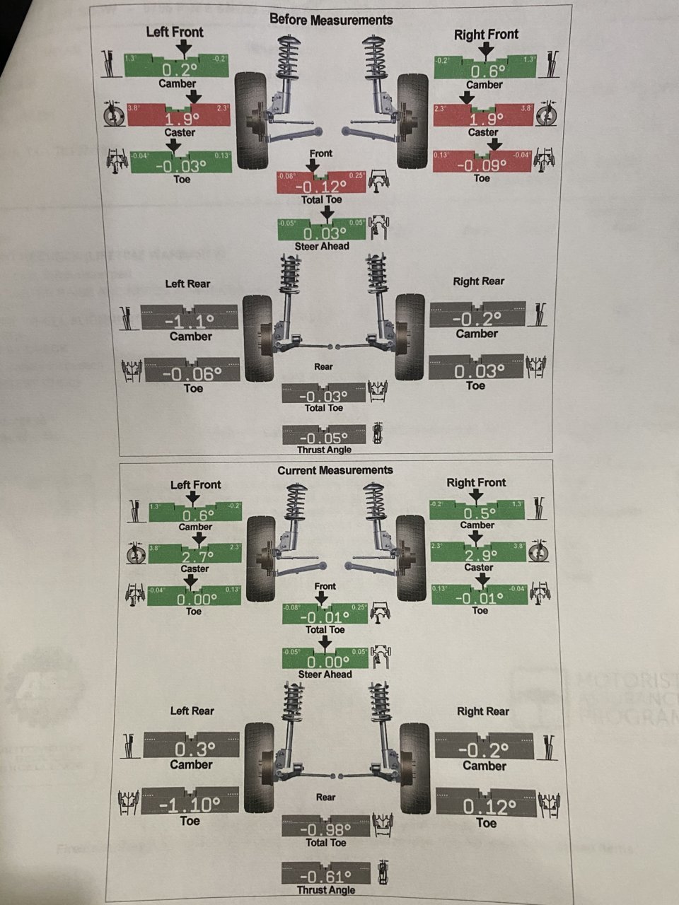

    I just got back from Firestone and here are my alignment numbers. I’m running Fox 2.5 coilovers 2.5” of lift, icon rear AAL, dirt king ball joint UCA, on 285/75/16 Toyo open country m/t’s. Just wondering if these are decent numbers or can I get it dialed in even more? I’m trying to get the best ride on my setup and save my tires as well. I was rubbing I did some trimming and only hit the cab mount at full lock now.

    Not bad, but what in the world happened to the rear? Looked fine before, now DS rear is toed out?
    Most would prefer a little more caster in the front but it probably tracks pretty good. How's it drive?

    I just saw that and I have no idea! Maybe I should go back to a different guy? It rides pretty good I mean when I hit a bump I get some shake in the wheel not sure if that’s just the tires and or suspension but it’s nothing crazy.
