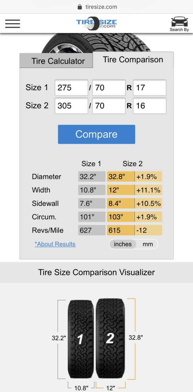

    I believe it’s all the same.
    If it eases your mind, my 305/70R16s were less than 2% taller than your 275/70R17s, mine were just extra wide. If I were to do the alignment again (with those old tires) with the knowledge I have now I would have asked for more caster.

    for two tires that close calculators are not much of a tool. You could find a big difference between tire brands for the same size tire and then you can also make a difference with air pressure . Look up the specific tire and read the manufacturer's specs if its that critical to ya.
