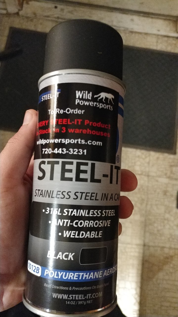

    @Torspd weldable paint? Never heard of it. Who makes it?

    Torspd Custom Turbo kit [] Borg Warner 9180EFR Turbo [] Haltech Elite 2500 [] TiAL Q BOV [] TiAL V44 Wastegate @ 15psi [] CP Pistons [] CP Carrillo Rods [] ARP Head studs [] ARP Main Studs [] ARP Header - Head Studs [] Ported Heads w/ 1mm oversized valves intake/exhaust [] Brian Crower Forged Stroker Crank [] Darton M.I.D. Sleeved Block [] Kelford Camshafts [] Torspd 160* T-stat mod [] APR Large Fuel Rail [] Walbro 460 LPH E85 Fuel Pump [] FueLab FPR [] APR T56 Conversion Kit [] KP RACING Built T56 [] McLeod Racing Custom Twin Disk Clutch [] One Piece Aluminum Driveshaft [] MGW Shifter [] Custom lowering kit [] Ohlins Front Coilovers [] QA1rear shocks [] Custom Ron Davis Radiator [] Dual SPAL Electric Fans []
    That is what we used on his frame. Arc'd easily. As if it was bare metal.
    Can grind all of the weld area clean, then spray that over everything, so it all stays protected. Then weld right through it. Touch up if necessary. Nothing gets left unprotected.

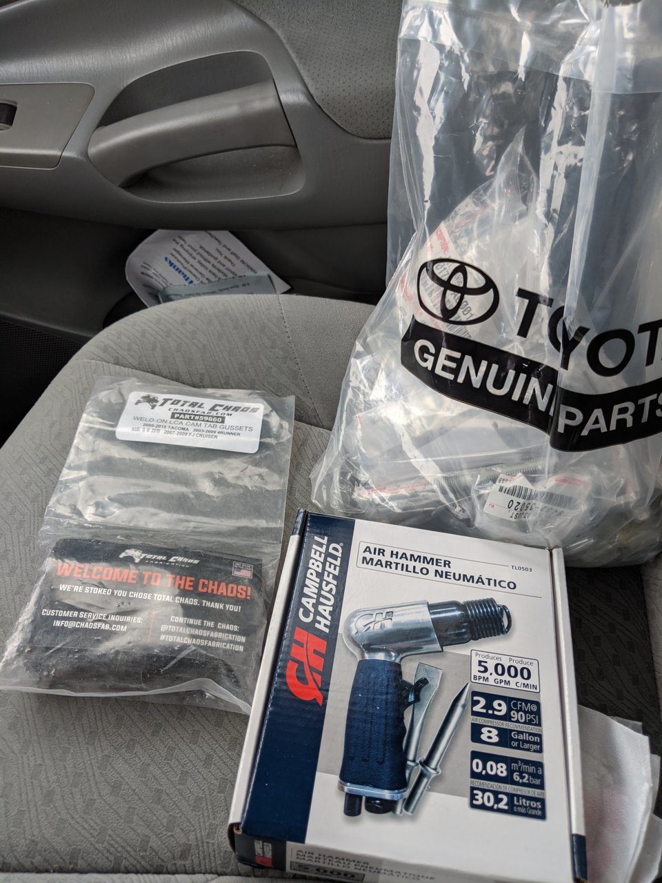

    Oooooooook.
    Cam tab gussets. ✓
    Air hammer. ✓
    Complete replacement hardware for mounting the LCAs ✓
    1 each front and rear LCA bushings. ✓ :annoyed:
    If I'm gonna do one, I should do them all. Can't afford that, and I'm not just doing the one. The other LCA will get some love down the road.
    How bad do these bushings suck to replace? If the air hammer doesn't do the trick on the seized bolt, it's getting cut. From there: a drill, jigsaw, and a chisel. It IS coming out. Oh, ya let's not forget the bfh...
    Putting the new ones in though, will a c clamp be sufficient or do I need a bj press? Or will they hammer in?

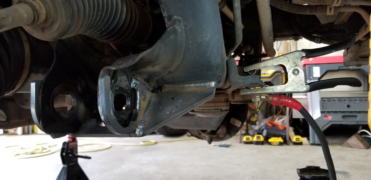

    Yaaaaaa, those bushings just looked up and laughed at me...
    Got one side done. Ended up replacing the LCA though. 5 sawzall blades later and it was out.
