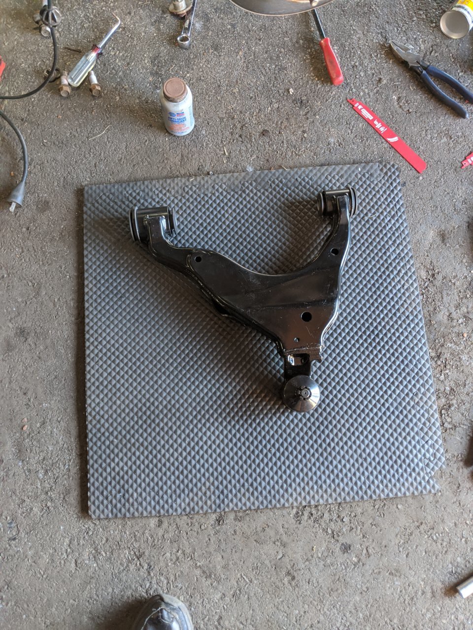

    Say hello to my little friend....
    Swapped out the other LCA yesterday.
    Can't get the other tabs welded in for a couple/three weeks; so I gotta get this aligned.
    I didn't have luck and the air hammer was a no go. It just bounced in the rubber.
    That can of worms I mentioned earlier....passenger side wheel bearing. BWAHAHAHAHAHAHAHA
    Wtf....
    Edit: the napa pre assembled units are warranteed! Psyche!
    Edit again: didn't mention the passenger side upper ball joint... :annoyed::spending::annoyed:

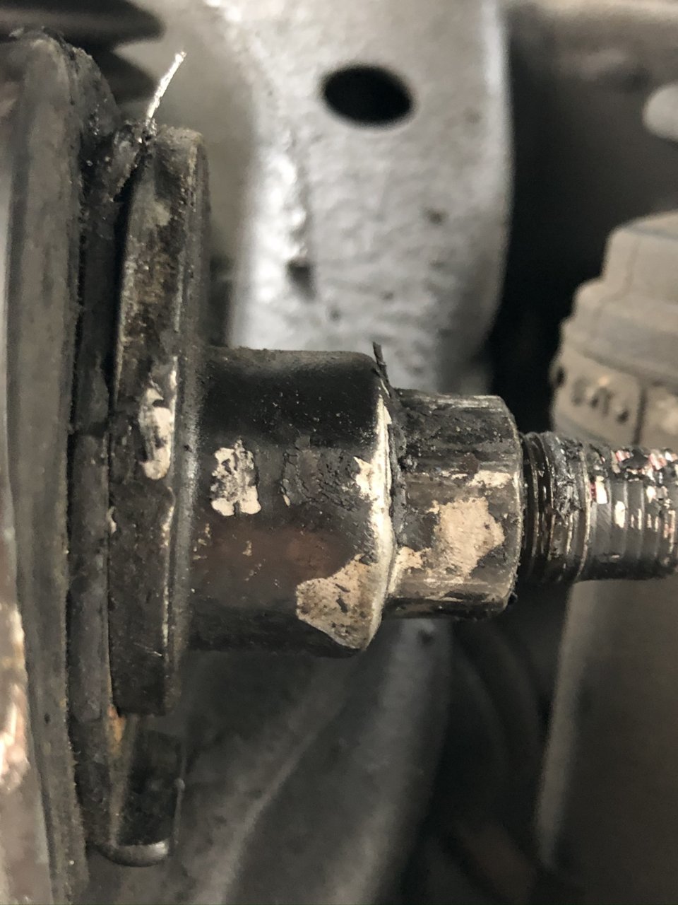

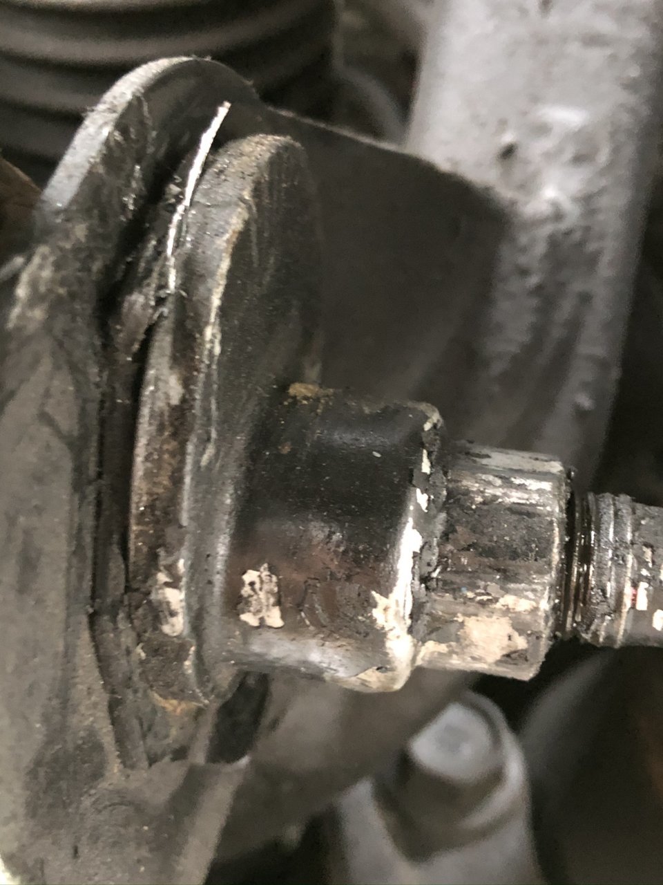

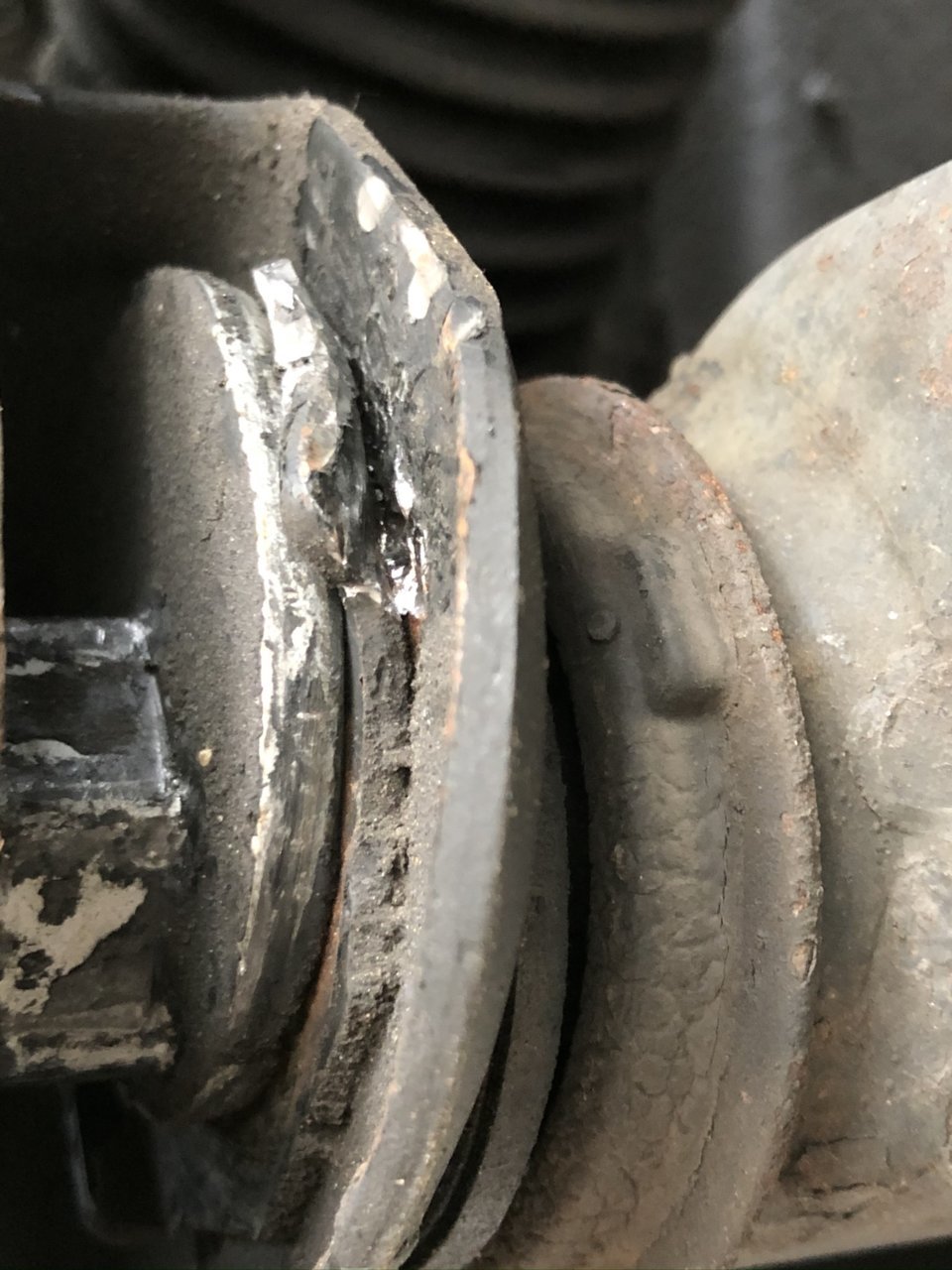

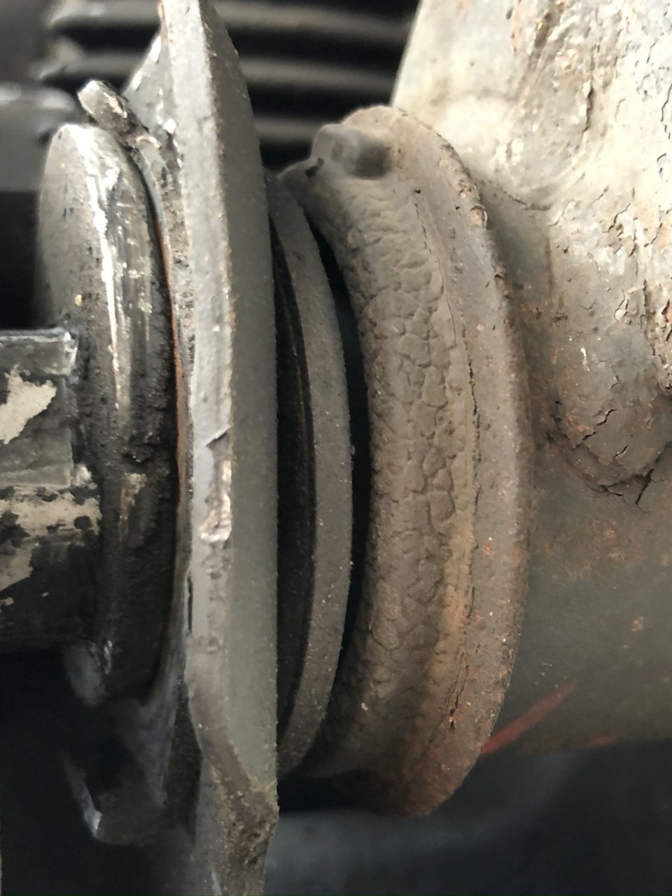

    08 Indigo 4x4 DC OR
    Mods are currently being changed .....
    I had another alignment done yesterday and they mentioned one of the tabs bent. They werent kidding! This is more like, folded over! Just the front driver side tabs are like this. The rest seem to be fine. Thoughts?
    Alignment numbers looked like this afterwards:
    Camber 0.5 -- 0.2
    Caster: 2.8 -- 2.8
    Toe: 0.01 -- 0.01
  5. Sep 3, 2020 at 11:55 AM
    #65
    shaeff
    shaeff Roaming Around
    May 22, 2016
    #187639
    580
    Hudson Valley, NY
    '07 DCSB SR5 6MT 4x4
    Those tabs have bent over on any Toyota I've ever owned. I've always run a bead of weld behind them once I get 'em square again. Never an issue after that.
