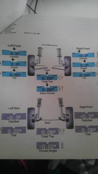

    I replace the UCAs with LR UCAs and set them at +2 deg, and I also replaced both of my LCAs with newer stock ones. I did a redneck camber alignment using the top LR UCA ball joints and let them take care of Toe and fine adjustments on the rest.
    I just got mine back this is the PRE:
    What do you think: the POST:
    Not really an issue, but saw that one of my eccentrics was maxed out, Front Camber on the passenger side is maxed out, but the specs look great, and it rides fine so I am not going to worry about it.
