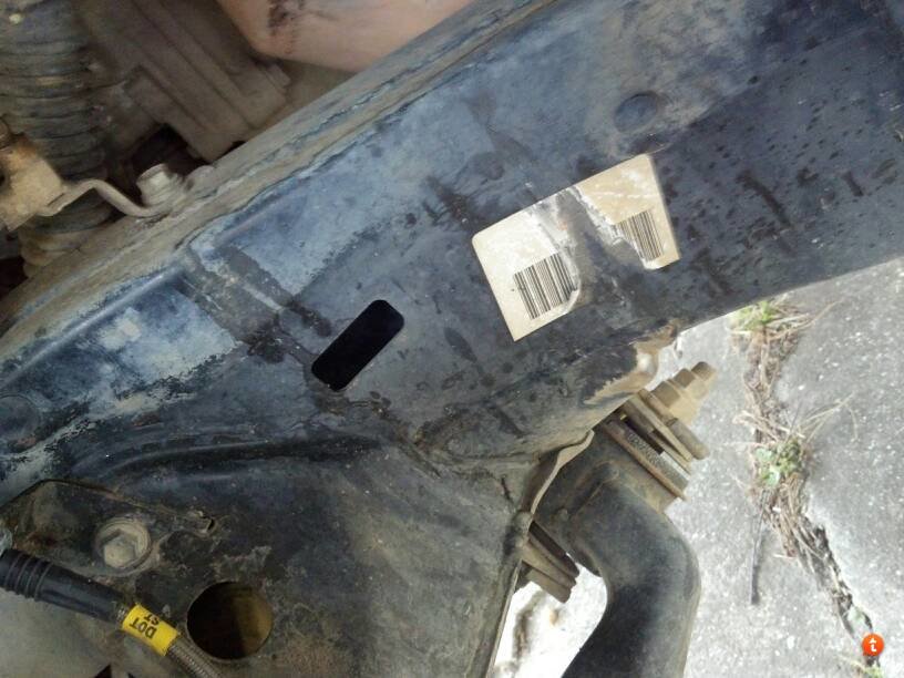

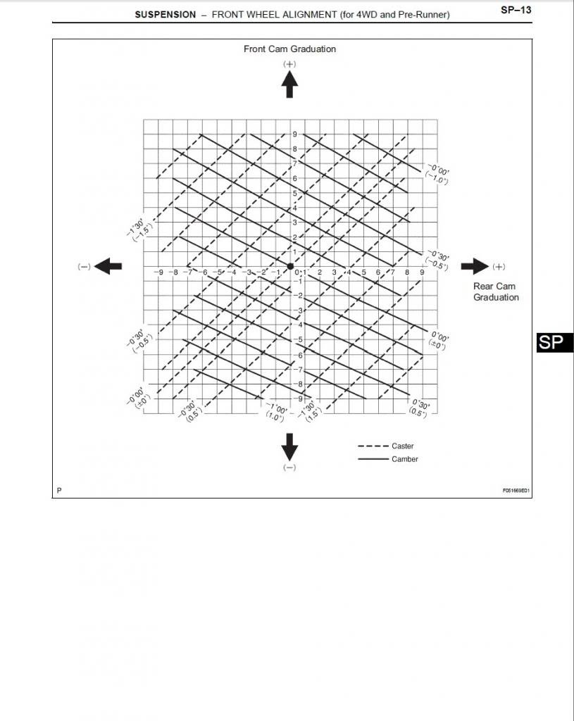

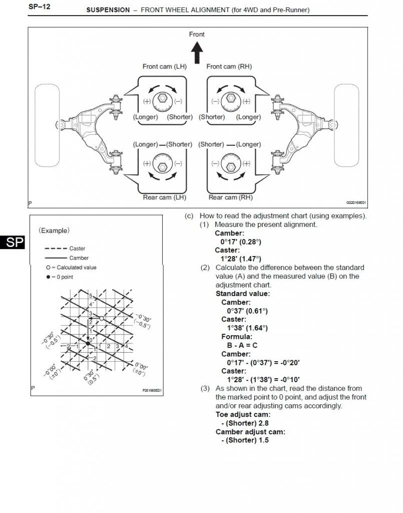

    Thanks for the input guys. Ya I think I'm going to remove the skid plate and show the tech the cam adjusters on the lower control arms. Maybe a couple of carne asada tacos will get the tech off his ass. Thanks again for the help.

    seanboy
    seanboy Well-Known Member
    Aug 15, 2013
    #110483
    47
    '13 TRD Sport
    You're right! Good catch! I miss read the sideway picture. Don't judge me! :D:cheers:

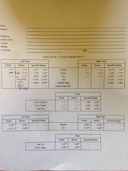

    I just got my alignment after installing 884's and a rear leaf for approximately 2" lift all around. My front right tire appears to have positive camber, but not the left. I really don't want to grind down these beautiful new Duratracs. Here are my alignment specs. I'm going to have to take it to a different shop but would love to be armed with some knowledge going into this again.
    Here is my printout.

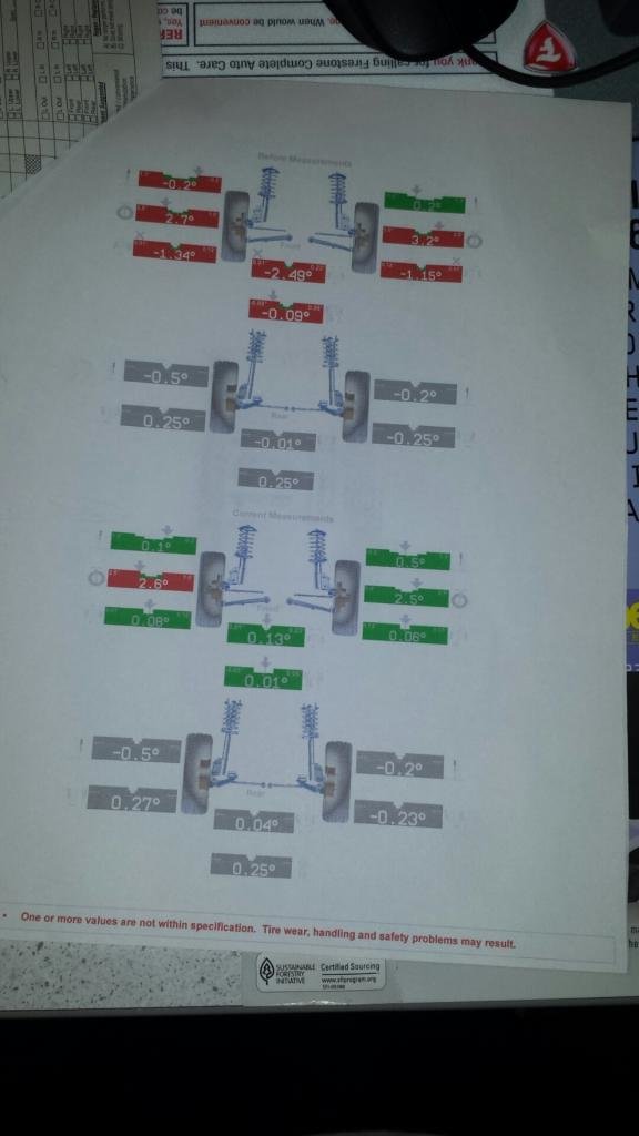

    Got my alignment done after my lift. I have fox coilovers and total chaos uca. I'm pulling right and my steering wheel wobbles at 40ish to 60ish mph. Here are my numbers. Would getting the toe and camber closer to 0 help?

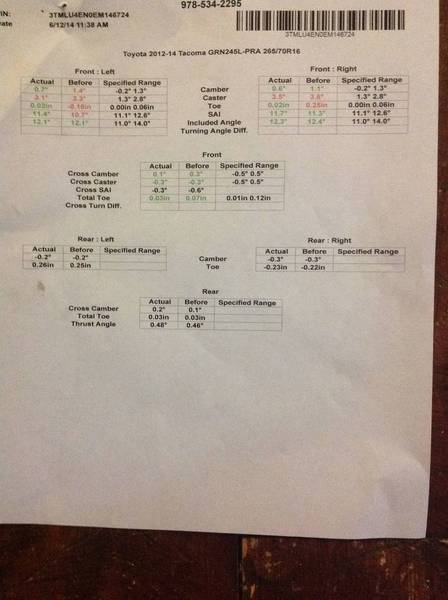

  13. Jun 12, 2014 at 1:36 PM
    #353
    G8keepr
    G8keepr Well-Known Member
    Apr 20, 2014
    #128087
    339
    Rich
    North central mass
    2017 TRD OR
    Just installed lift and got alignment. Drives great

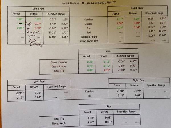

  15. Jul 2, 2014 at 2:57 PM
    #355
    SCRunner12
    SCRunner12 Tundra Troll
    Aug 8, 2011
    #61363
    9,115
    Robert
    Santa Cruz, CA
    2006 Tundra DC, TRD, 4wd
    I got an alignment and after my 4runner (1st gen taco specs) has a drivers side toe of .02 degrees and passenger of .1 degrees. Is that anything to worry about?
  16. Jul 2, 2014 at 9:04 PM
    #356
    TrueNorth
    TrueNorth Well-Known Member
    Mar 1, 2014
    #124305
    177
    Maryland
    13' V6 4X4 DCSB
    Weather tech floormats and visors, ImMrYo rear-view mirror bracket Cooper ST Maxx 255/85/16 On stock TRD alloys. OME 887's w/NitroCharger sports, LR uca's, Toytech sway bar relocate, Dakar leaf's modified with some 1/8" UHMW liner strips. SuperBumps front and back.
    I wouldn't worry too much about that, but they should have dialed it to 0
  17. Jul 2, 2014 at 9:25 PM
    #357
    ProForce
    ProForce IG @proforce.expeditions OB#5411
    Oct 12, 2009
    #24205
    7,078
    Anthony
    Alaska
    09 MGM TRD Sport DCSB 4.0 Auto 2wd
    Too many to list. See build page. Link in signature
    .1 Toe is ALOT. .01 toe is more reasonable. Both should be as close to 0.0 as possible. if you meant to say .02 and .01 then your good. but .02 and .10 is not good. Should be under .02 on both
  18. Jul 2, 2014 at 9:36 PM
    #358
    TrueNorth
    Mar 1, 2014
    #124305
    177
    Maryland
    13' V6 4X4 DCSB
    ^ good catch. I thought it was .01 not .1
  19. Aug 7, 2014 at 11:57 AM
    #359
    parkp81
    parkp81 Well-Known Member
    Feb 15, 2011
    #51228
    123
    Fil
    Southern California
    First image is alignment specs before lift. Second image is after lift. TX Suspension Kit. Got over 2" lift on the front and Firestone Ride Rite airbags with Daystar cradles on the rear with 10 psi.
