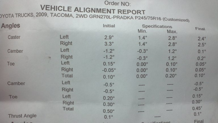

    nfs257
    nfs257 Well-Known Member
    Jun 22, 2011
    #58691
    7,530
    DFW
    She gone
    How does this look? :notsure:
  20. May 18, 2012 at 9:44 AM
    #80
    anthony250f
    anthony250f Well-Known Member
    Feb 18, 2012
    #73066
    16,780
    Anthony
    San Diego, CA
    2008 dcsb trd offroad 4wd
    they look perfect... lucky
