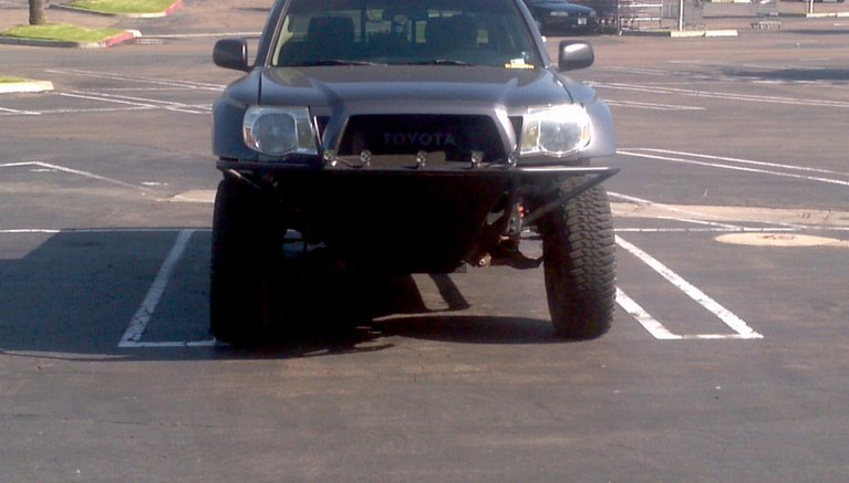

  18. May 27, 2012 at 9:14 AM
    #118
    nfs257
    nfs257 Well-Known Member
    Jun 22, 2011
    #58691
    7,530
    DFW
    She gone
    I replaced my UCA's and now getting an alignement but look at the way the tires sit right now...
  19. May 27, 2012 at 9:27 AM
    #119
    BTO
    BTO Well-Known Member
    Nov 12, 2009
    #25836
    501
    California
    '07 Silver PR DCSB SR5 V6 AT TP LSD
    Bilstein 5100s front, Adjustable Ranchos rear.
    Ouch. Looks like serious negative camber.
  20. May 27, 2012 at 9:32 AM
    #120
    nfs257
    Jun 22, 2011
    #58691
    7,530
    DFW
    She gone
    They are saying they cant get anything but the toe into specs... HELP?!?!?!
    I have TC UCA's and lift spindles...
    I will post picture of the sheet shortly...
